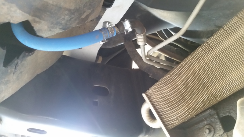

Ends up the difficulty was finding the correct fitting to plug into the cooler. It is not a flare type fit. As I mentioned, the atf was leaking out the center of the bushing.

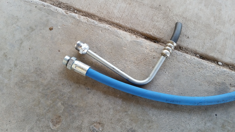

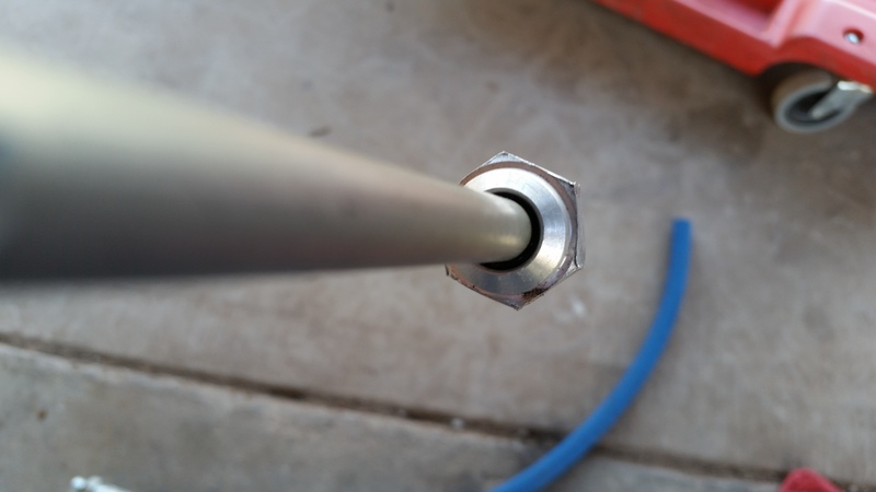

I got educated by the hydraulic hose guy. He showed me how these fittings have a c clip in the back of them with an o ring on top. Didn't really show up in the pic, but I could see it with the naked eye. Not sure what kind of tool you could use with such limited clearance to remove the clip, but if you could, you could simply replace the o ring inside the bushing.

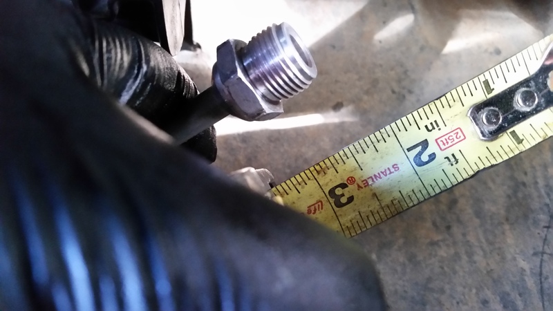

Instead of messing with that, he just built me a hyd. hose that screwed right in. $20.

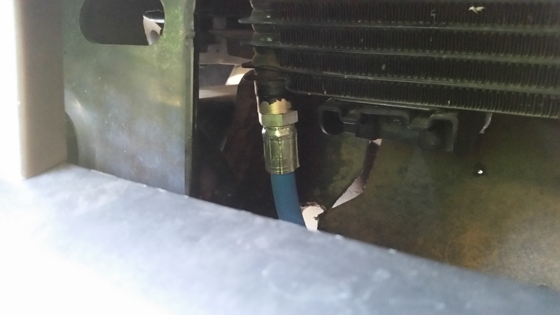

The 3/8" double hose barb us a little ghetto, but I believe it will last. Most importantly, no leaky!
