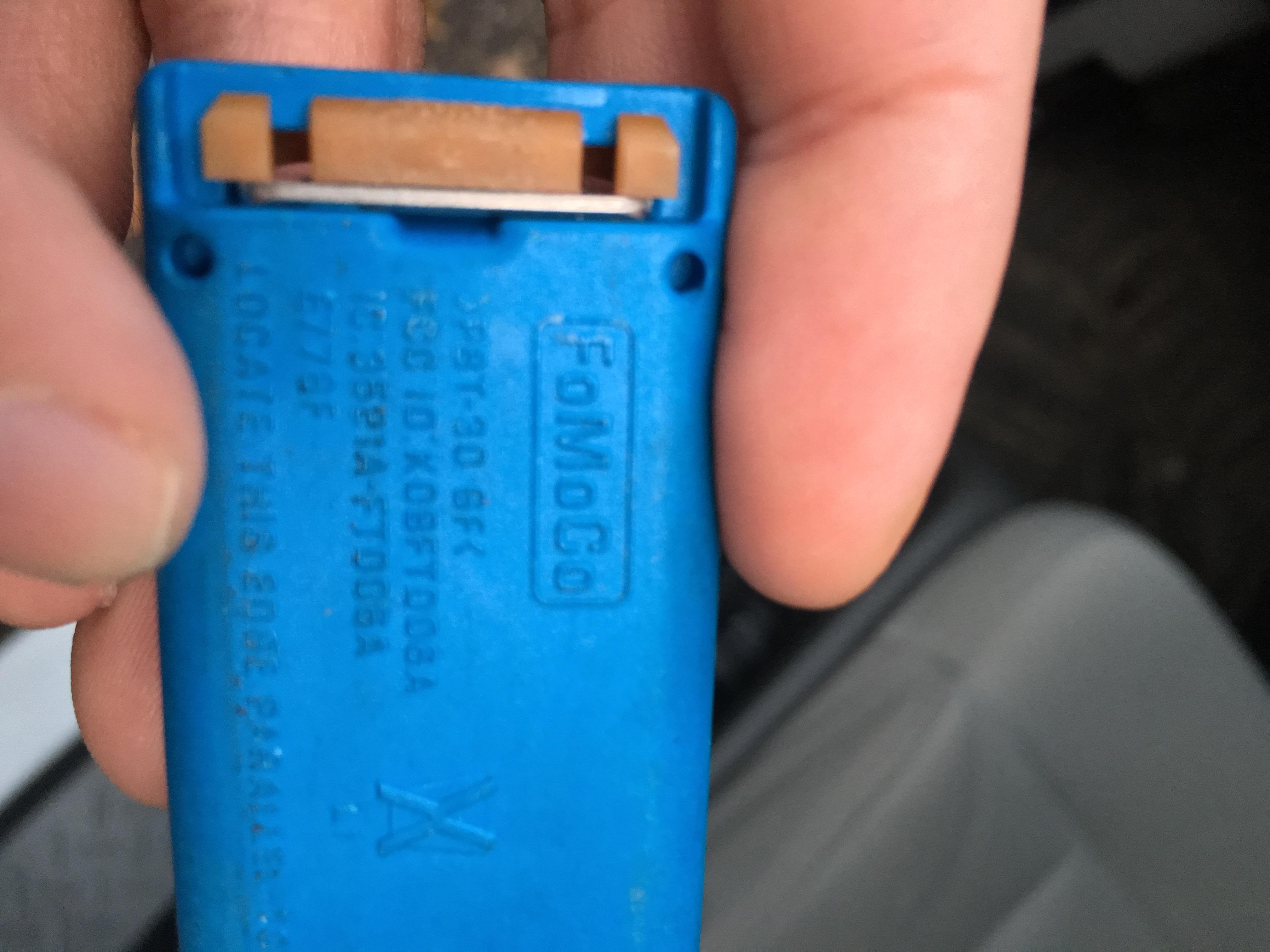

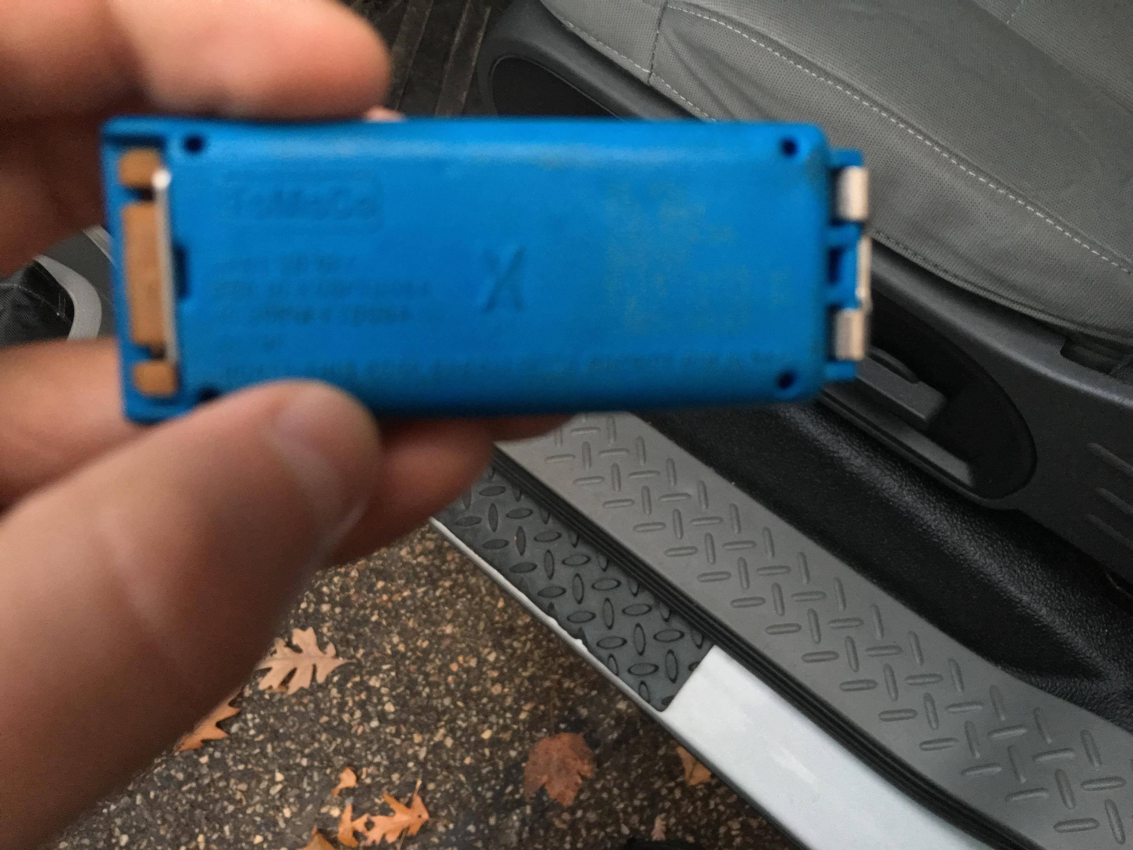

These are the ones for 2007-2008 F150's. You'd need to have new bands installed too. They're pretty much just huge radiator hose clamps and shouldn't cost more than $10 for all 4. The tpms needs to be mounted 180° from the valve stem. If the valve stem was at 12:00, you'd put the tpms at 6:00.
The tpms you have on your truck are already "learned" to your truck. The new/used ones will not be and you'll need a tire shop to re learn them for you. I **think** there's a do it yourself way where you have to deflate the tires and bit, the horn sounds, then you inflate them. It's a process in which I cannot remember at the moment.
Here's one of the ones from my original stock steel wheels (my new chrome clad are from a 2008 and already had them.)
