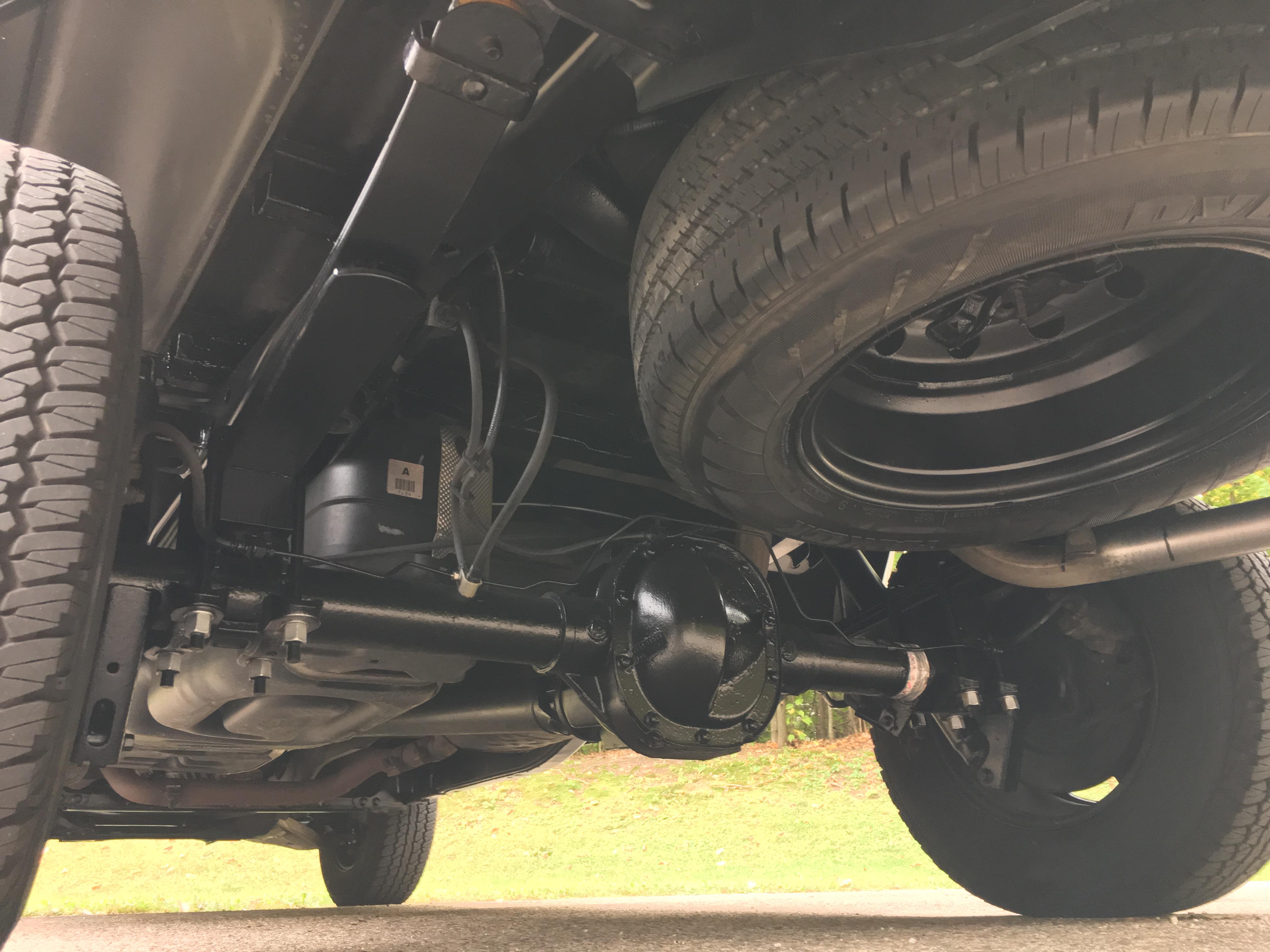

Just got my f150 back from the restoration shop and they did a magnificent job!

Say something about this photo

And I slapped some new tires on it for the winter

Looks good. Now get it oil Undercoated & rustproofed before winter!

Looks great! I agree, get it sprayed, or go buy some cans of Fluid Film and do it yourself. You just need to know all the known problematic rust areas. I've learned them all, if you need tips.

Yes pls I just sunk $2000 into the frame of this truck I need it to last a long time
Get a bunch of cans of fluid film. Spray the whole frame and cross members along with spraying inside the frame. Spray the bottom of the cab, bed supports, inner door lips, inner tailgate lip and up around the rear wheel wheels. You'll see openings that access the upper part of the wheel well when looking up from underneath the truck just in front and behind the wheel wells.

I want the truck to last now since I've spent $6000 total on it after getting a new frame on it
What did he do ... the welder? Did he plate or replace parts?
Looks like plated at spring hangers and almost looks like he plated the side but hard to see well in pics ..... definitely looks great now though.
As you can see, "2008_XL" knows all the tricks to keeping the bottom as sharp as the top side ...... I've been watching his threads for tips for years. If there's a way to keep it looking new, he's been there.
Thanks!
Also, op, don't forget the rockers. Spray those top and bottom and along the edge. Above the rocker there may still be prices of tape covering holes. Remove that tape and spray in there. Then get some type of similar tape and re cover.
