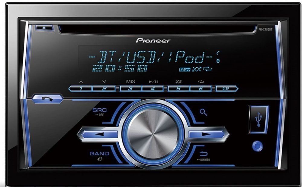

I think a unit like this is what your looking for right simple yet effective

I was looking at aftermarket radios like that, only thing I didn't like was that the lights don't match the factory green lights and the plastic is not the oem(for example in this posted head unit that plastic is gloss, where the truck has matte finished plastic).
For that reason, for me what looks best is the huge touch screen units that take up the entire double din, but they are pricey......
