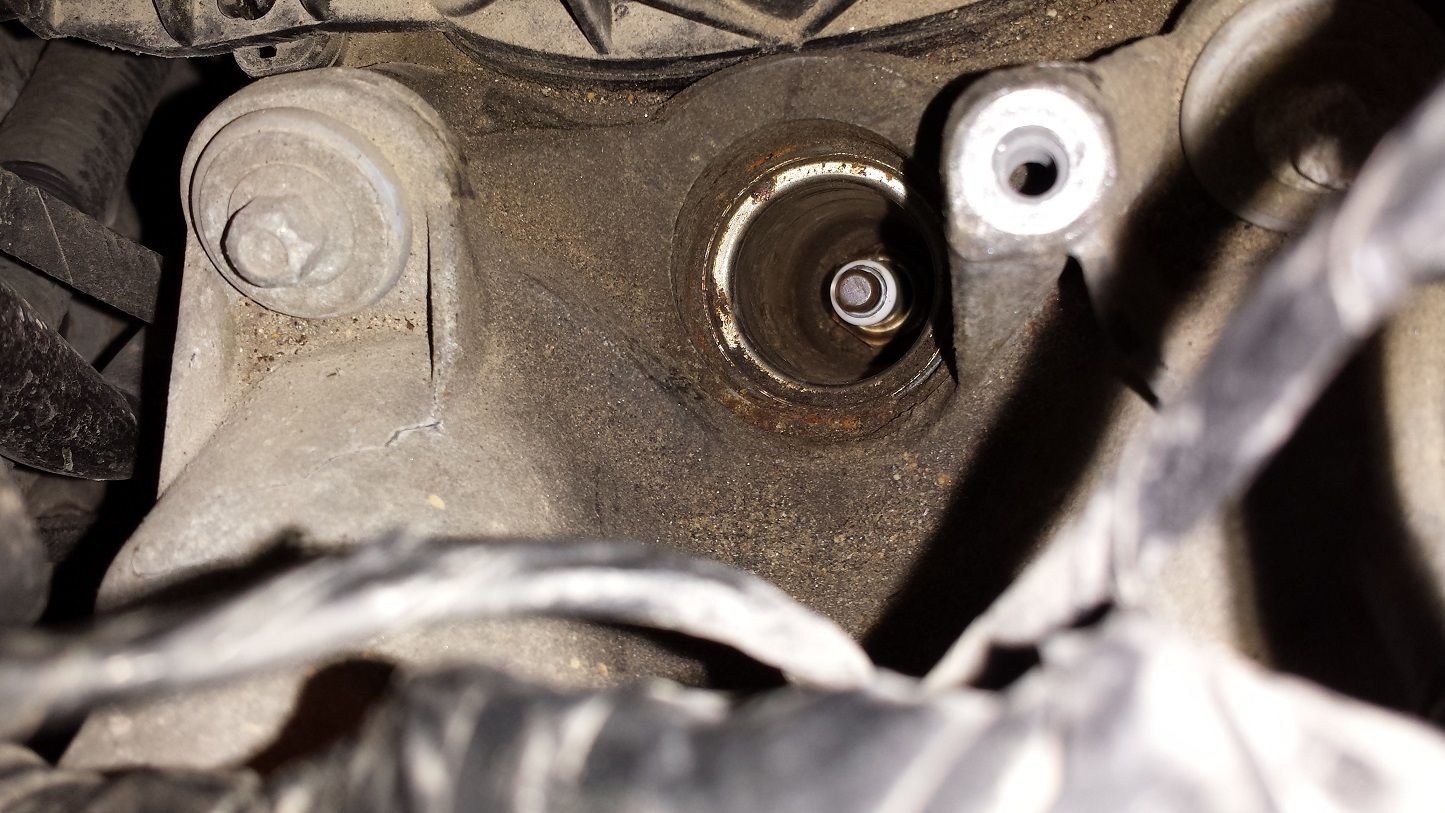

Not intending to hijack your thread but I have the exact same issue with my 06 5.4l 99k miles. Plugs were replaced by previous owner (at shop) around 70k. About 9 months ago I got a misfire CEL on cylinder 4 (I have true dual exhaust and you could hear misfire from passenger side pipe). I swapped COPs on 4 and 5 hoping to verify it was a spark issue and the issue went away completely until about a month ago. Now it is getting progressively worse, but with no CEL. Same exact symptoms as yours (intermittent misfire at idle, when coasting, and dramatic fuel mileage drop) and the misfire can be heard from passenger side pipe yet again, making me think it is not a COP failure. I am thinking of taking it to be diagnosed by shop, I will let you know what I find.
Sometimes switching COPs may fix it for a little bit, if the boot is damaged or a carbon track on it can cause a miss fire shorting from the boot to the inner wall of the spark plug channel/tube. This may not set a code because the spark is still firing most of the time. Coils could be starting to go bad too.
Okay so first some background on my pickup. Plugs were replaced by a shop around 50-60k.
Started getting CEL (finally). It was P0300 and P0304. So I pulled the plug from #4 tonight and the entire "interior" part is covered in a wet/burnt oily residue. The threads were also chock full of debris, making backing the plug out a pain. Nervous about putting new plug in because as soon as the threads grab its very hard turning. Pulling the new plug out after about a quarter turn the sleeve is covered in residue and the threads are full of crap like the old one.
What I'm figuring is oil in cylinder = my misfire at idle issue? Am I looking at bad piston rings? I have yet to pull other spark plugs because I'm scared they will be a pain to reinstall like #4.
OP have you checked your new Champion plugs to see if you have similar oily residue?
