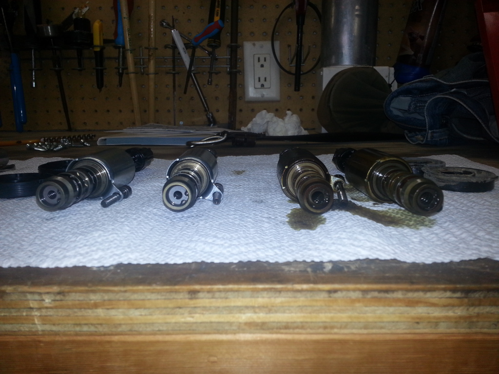

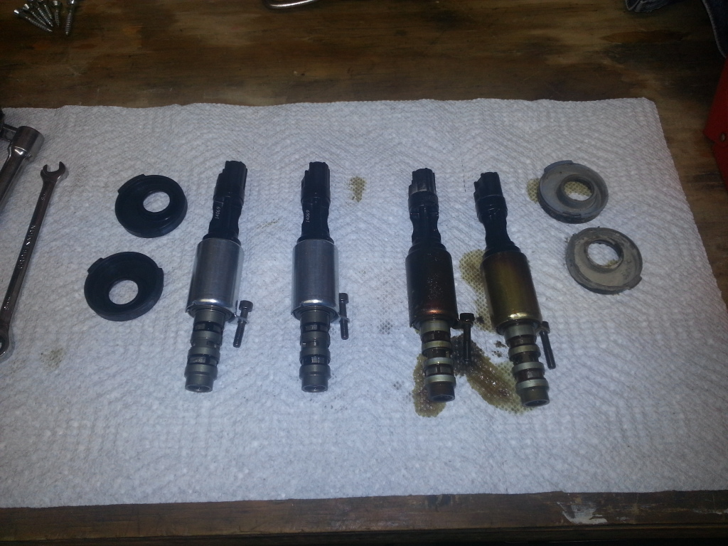

I had posted a thread about my VCT solenoid replacement on another F150 forum this past weekend but here is some pics of my old and new Solenoids as I replaced them. Also a before and after video of the difference they made for me......
