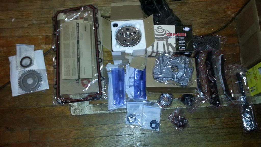

Timing Parts
2 Chains, Crank Sprocket, L/R Tensioner, L/R Tension Arm, L/R Guide Rail, Oil Pump, Water Pump and more...

Timing Parts
