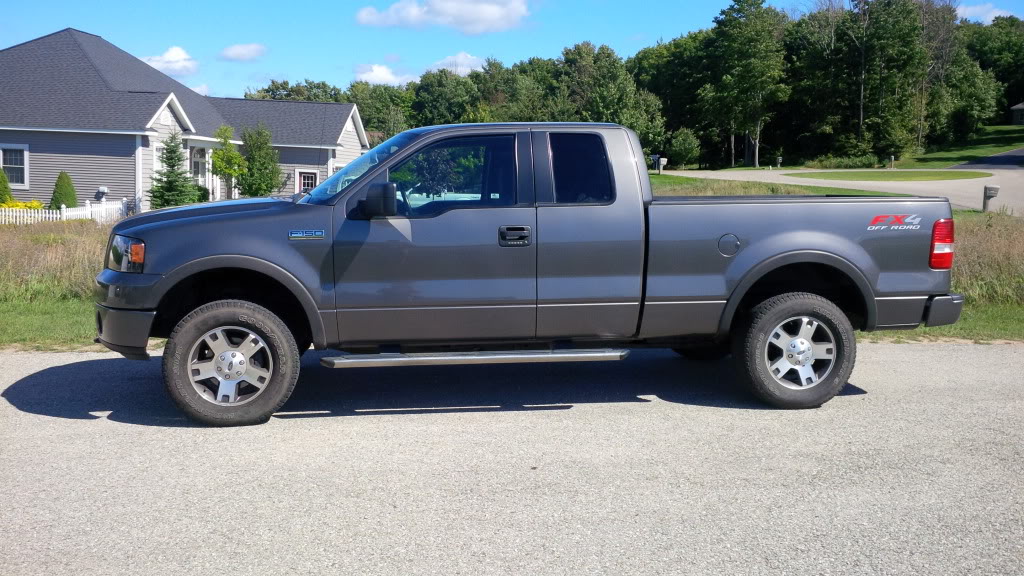

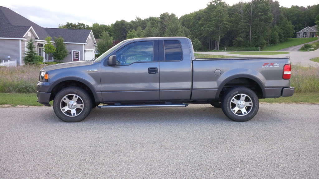

I'm glad I went out to my truck and literally measured pavement-to-top-of-fender in the rear and front and there was exactly 2" of difference, so I ordered the 2" autospring kit, which was perfect for my truck (glad I didnt order the 2.5" kit).
Before:

After:

I wonder why some trucks only need a 2" kit vs a 2.5" kit... maybe something to do with a difference for the FX4s?

Looks good! And all trucks are different, every option you add/don't add effects the weight just like the engine, stuff in the back seat, etc can all effect it's ride height, plus age is a factor too. Generally though 06-08 need 2" and 04-05 need 2.5".
