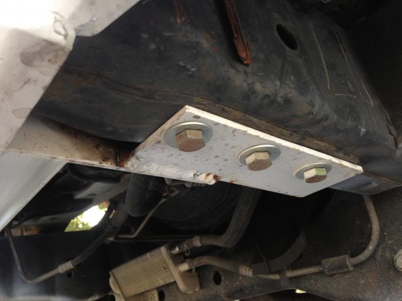

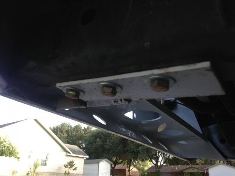

Hey OP could you post up close ups of where you welded it and where it meets the front fenders I test fit it tonight and just wanted some more guidance of where its supposed to sit
Thanks
You will definitely want to get these powdercoated before hand if you want to do that. Once you get it on, it would be crazy difficult to get your hand back into the frame to unbolt it. I got the bumper and brackets powdercoated, then ground off the powder where I needed to get welded. A quick shot of white spray paint protects it from rusting. Its in areas were no one will ever really see either so overspray didn't matter.
Here's some pictures:
underneath looking to the front of the truck

underneath looking towards engine bay

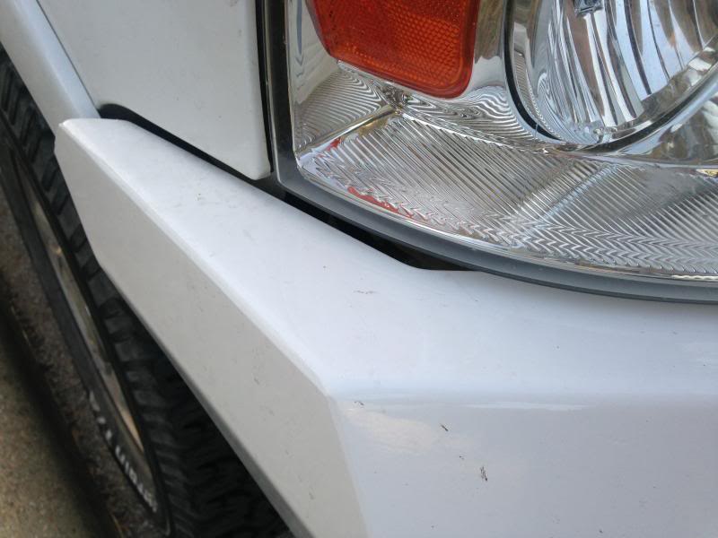

hard to get this one, but from inside the bumper looking at the top bracket to the front of the truck
Where the bumper meets the light and fender. This can vary though based on how you want to do it. That is a perk of bolting the brackets on and welding the bumper to the brackets. You can have as little or as much gap here as you want.
