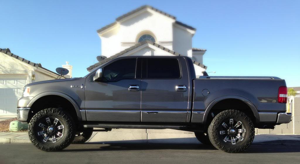

Here is mine, I have the same lift with i think the 4in block. Pretty close to level.

I dont want to lower the front to match the back. I ordered 5 1/2" blocks to bring the rear up the fx4 sits different than a normal f150 ive seen many trucks with the front sitting up higher. I think it will be alright. its is a 5.4 ill post up pics when im done for sure

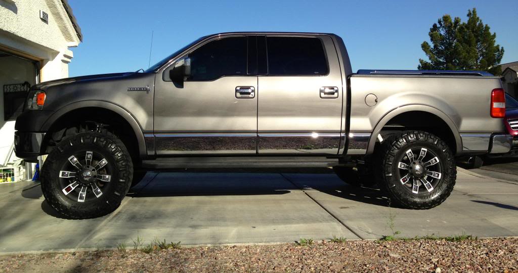

Here's Mine with the same lift.

Thadragon did you put the 5.5 blocks in the rear?
Old Mar 18, 2013 | 04:07 AM
Thadragon's Avatar
Joined: Jul 2012
Posts: 11
Actually NO. all i install are the ones that comes with the 6" lift
