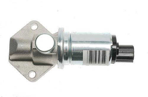

ok we all know by now that the TB gets dirty so we've gone thru and changed things like throttle position sensors cleaned or replaced the MAF sensor replaced the fuel pump master control unit, even replaced the entire TB to no avail. I've got 1 more suggestion before I say we take the vehicles back to ford en mass and tell them to park em where the sun don't shine...try replacing the idle air control valve.
Old Sep 18, 2020 | 11:33 AM
Posts: 43,538
1. This thread is 8 years old.
2. The thread is about issues with a 2006, which does not have a IAC.
