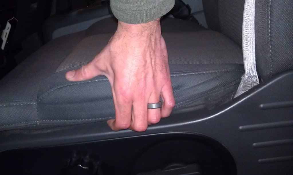

Push your fingers between the cushion and the plastic part along the seat. You'll feel the metal part in there, just pull it up really hard.

Thank you for posting that pic. It was very helpful. Now I get it!

After pulling on it the squeaking seemed to subside a bit. I need to try again. That seat plate is thick and very hard to bend. Did anyone use anything to pry it up? I just don't want to rip the seat cloth.

Def fixes the squeak until I sit on the seat again and push whatever I'm pulling up back down. What is that part that is squeaking? Wonder if they will replace it under warranty.

Didn't work for me. I felt the pan you're talking about, and pulled up on it. Even got a big flatblade screwdriver and some cardboard for cushion and pried up. But, this did not affect the sound at all. I think the track needs greasing. Will be searching for more before trying to wing it. Hope I remember to update here with results if I'm successful.
