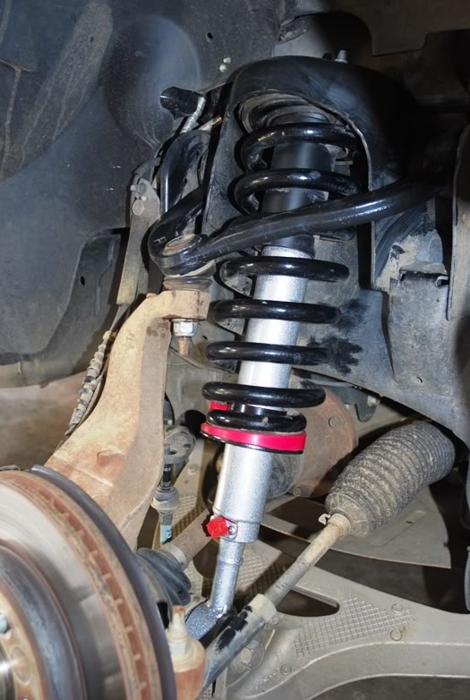

Rancho has a similar product to Bilstein called a QuikLift. I doubt your level had anything to do with the spring failure. It was more likely the spring had a bad heat treatment. You also retain the top plate with the leveling shocks. I think you could use a 4x4 stock shock for some lift, but I think one of the leveling shocks would be a better choice. Here is a QuikLift shock next to a stock shock on a 4x4.
Shock installed on the truck

Check out this application chart from Rancho's website. It lists the part numbers for 04 - 08 F150 2WD as:
QuickLift Loaded Front Struts part# RS999909 and the RS9000XL Rear Shocks part# RS999285. The chart says it will give your 2wd a 1.75" height increase on the front.
The QuickLift loaded are also called QuickStruts on some sites, but the part number is the same. It comes with the full assembly, spring and all ready to go. I just bought a set of quicklift loaded leveling struts and rear shocks for my '07 4wd and I can't wait to put them on. I bought them from http://race-mart.com which had great customer service and the cheapest prices I could find. I also like them because they are adjustable, so when I tow, I hope to tighten them up for better control and decrease any rear sagging.
Here is a picture of them straight out of the box:
