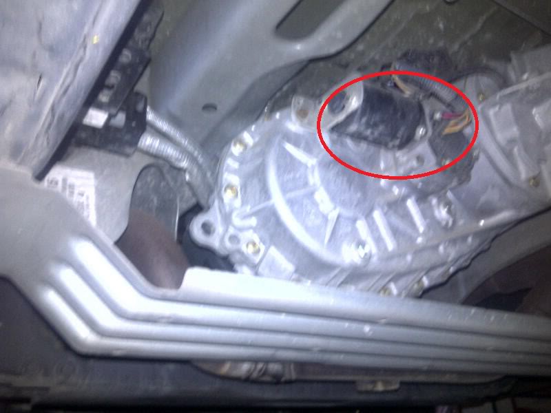

Glad it worked but i want to clarify, you don't hit the transfercase, you hit the transfercase shift motor.
As for is the problem fixed? Mine still sticks and it's a PIA. But it does't do it all the time. Just need to make sure that you exercise it by putting it in 4wd ever few weeks and you should have much fewer problems.

Thanks for the pic. I gave the shift motor a couple of love taps too!
