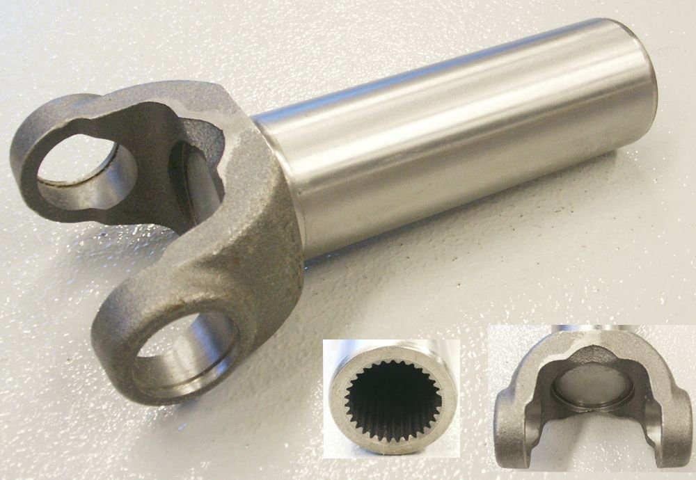

I'm getting ready to try some DuPont Teflon High Temp grease, but I have a question that is probably easy for most of you.
When I removed the drive shaft, a small amount of oil leaked from the transfer case. Is this normal or is the seal bad. Plus there was some of the oil in the slip yoke.
Last, do you grease the slip yoke that goes into the transfer case or does the transfer case oil keep it lubricated?
Thanks.
Old Feb 14, 2016 | 09:03 AM
1-HIGH-4-BY's Avatar
Joined: Jan 2004
Posts: 250
From: Adrian,MI
Thanks.
The small amount of fluid that leaks out is normal. The way I found that works best is clean out the slip yoke really good with brake cleaner and apply new grease. I've always used hi-temp bearing grease and it lasted about a year.
My 2001 supercrew did this and I finally replaced the slip yoke and clunk was permanently fixed. I'm pretty sure if you're getting the clunk new grease just mask the problem. I don't know how but the yoke splines wear out.
In reference to the grease you are talking about, are you applying that only to the slip yoke causing the bump sound, or are you also applying it to the splines of the yoke that go into the transfer case?
My confusion is about the splines of the yoke that go into the transfer case. Does the oil in the transfer case keep those lubricated, or do I need to put grease on those, too?
Thanks.
Old Feb 14, 2016 | 10:20 AM
Joined: Jan 2004
Posts: 250
From: Adrian,MI
Thanks.
Apply the grease to the slip yoke on the DS. Trans fluid will get in there but it isn't what lubricates it. After you clean the slip yoke out with brake cleaner the grease sticks and applies really well.
