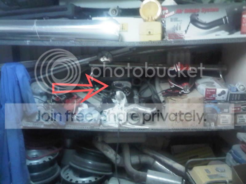

5 bucks says you cant find the Whipple!!

Good eye, I guess I owe you 5 bucks lol
