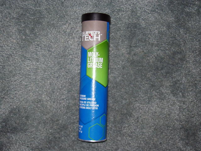

I highly recommend moly lithium grease.
I've used this with good results:

I'd suggest putting the truck on jack stands or a frame lift and running it thru the gears while looking underneath. Are you sure it's not the front end engaging? The system will engage the 4x4 if the vacuum falls which it will during acceleration.
The Ford recommended grease for the slip yoke is a teflon grease, not a lithium. The shearing at the slip yoke is tremendous and the teflon keeps things moving like it should.
