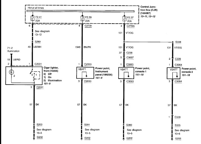

I was gonna take it to the dealership bc its still under warranty but i dont want it there all day. if it is a fuse i will take it in. where should i start looking?

Which one or all?

the one on the dash with the flip open cover. closest to passenger side

This should help out. There are 3 individual fuses all 20 amp yellows. You'll be looking at fuse F2.39. If that's good pull off the radio trim bezel and unplug the power outlet and check for power on pin 1 and a good ground on pin 3 using a multimeter. It also may just not be seated good.

thanks for the help it was the fuse... i thought the fuse box was where it was in my dads 250. (under the steering wheel) but i found it on the passengers side kick panel. thanks again!!
