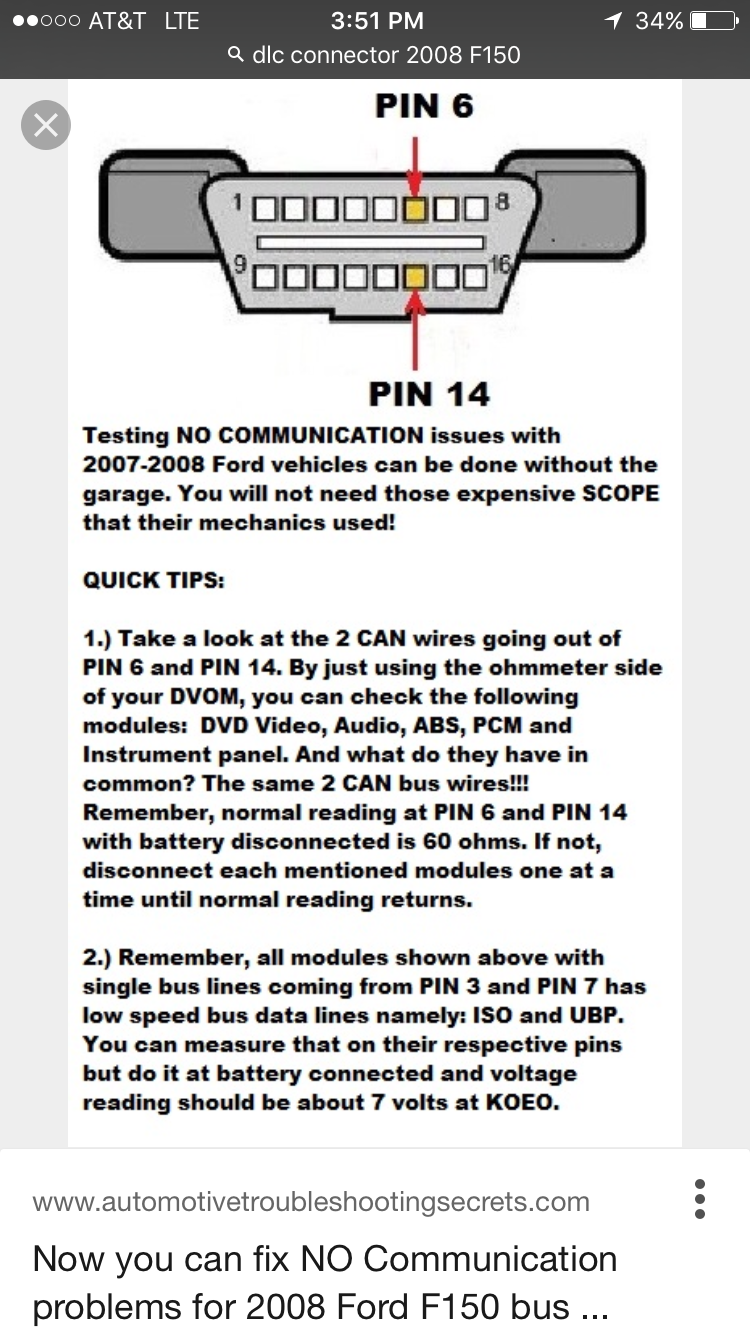

Ignore the text. Good diagram of which pins I found have the CAN bus on them.
