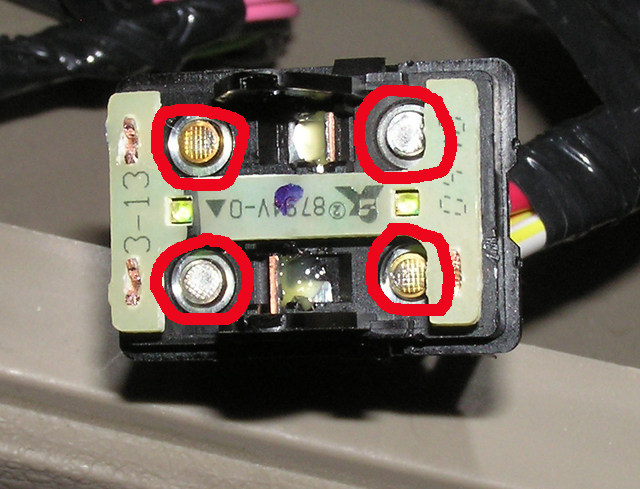

Here is JackandJanet's write up on repairing the LED's in the switches. It tells you how to take them apart:
Reparing Lighted Switches
The contacts I've circled in red, below, are the ones that get the carbon buildup. Just clean them off, maybe use a nail file or a fine sandpaper. The carbon is really stuck on there, I was using the tip of a screwdriver to clean it off. Once you clean that up, they should work much better.
