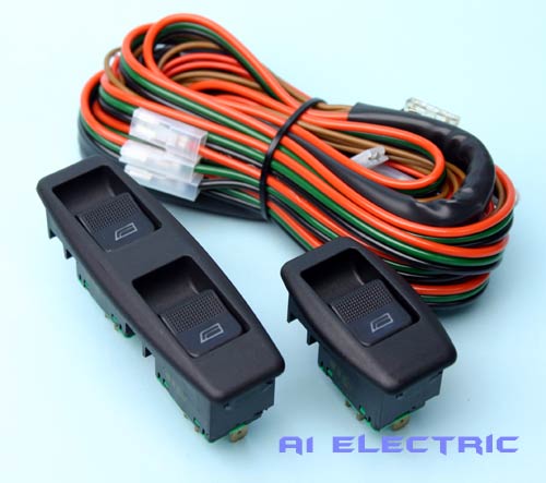

Okay so I read a ton of threads on this subject and am ready to go ahead with this project. I just want to make sure I've got my bases covered and a lot of the threads are older so maybe someone has some new insite to help out.
Here we go; Windows:
I got 3 OEM regulators slightly used for $50 each. The extra is when I get more time I'm going try to put power in the extended cab window.
Question: The used regulators/motors are for a crew cab, will they fit my extended cab?
I'm then going to order tonight A1 Electric switch kit (Pic Below)
