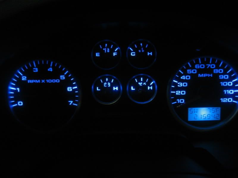

sry pics took so long, my level kit, HID's, and roush scoop came in so ive been busy with that. the gauges look kind of aqua but they are pretty blue. one thin i have noticed is the odometer is ALWAYS blue even during daylight, im gonna have to find a way so that it only turns on with the gauges or headlights at nite. the reason i dont want them on during the day is u can see only a blue circle in the center of the odometer and it looks ugly. at nite it is not noticeable. and yes the needles can not be seen at nite. i need to get some clear ones.

I was looking at doing this but then remembered my center console has all green lighting too! :/ Did you leave yours stock or also do the same thing as your gauges?
JMO, but the lighting and color doesn't look consistent. Looks blue in some areas, and white in others. In addition, you can see right where the light is behind the LCD; too bright.

GotTorque: currently looking at buying the individual LED's to make my a/c *****, window switches etc. blue. The radio itself is coming out next week so i dont have to worry about that. but eventually everything will be blue.
bamorris:there is actually no white at all. just the way the pic came out on the camera everything is blue. but yes since the bulbs are led's the lighting pattern does create "hot spots" where you can see a darker blue than in other areas. but it's not horribly noticeable. and for the odometer led its not that bright but it looks bad during the daytime cuz the blue only shines in the center of the odometer rectangle while the edges look normal, gonna try to fix that though.

hmm what about where the guage is supposed to be red, it appears to not show?

the red is on there during the daytime but at nite the blue led's make them pretty much invisible. the needles are prob. my biggest annoyance since i'd like to see my speed at nite oh well. the mod is not for everyone and i prefer this over the ugly green one.

I don't get it... On my truck, I believe that the needles are actually illuminated. Thus, the color of the guages wouldn't matter. Did you remove the bulbs that light the needles?

there aren't any lights for the needles themselves. it shares the light from the gauges. thing is since the lights are blue LED's the color is too dark to illuminate the red. if i were to switch to something like white it would light them up great.
