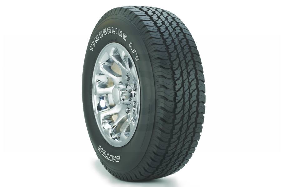

I know I may get destroyed for reccomending 'cheap' tires and it may not be what you are looking for, but I have Dayton Timerline A/Ts on my truck, 275/65/17 as far as I know that is the size. They are a Bridgestone Tire, but Dayton is there off brand.
Had the 255s before.
These tires around only about $100 each and were absolutely awesome in the snow this winter (we set record snowfall amounts most places in Ontario) and I live in a parking lot that only gets plowed on Sundays if it needs it (I live at a church).
Im a BFG AT KO man on my last truck, but these tires fit my budget and Im really happy with them after about 10k miles
http://www.hughestire.com/showcaseproductdetail.htm?ID=5900358&Brand=80&Type =3010
(I didn't buy them at Hughes Tire, that was jsut the first site that came up on Google)
They are a good tire also. I wasn't aware they were that cheap though.
