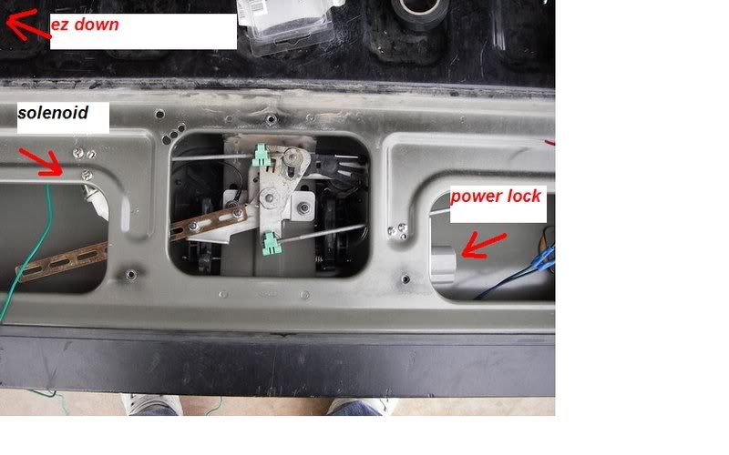

obviously you will need an ez down otherwise the tailgate would drop way too fast
also the power lock write up can be found on myst's website found here
MYST'S WEBSITE
ok well here is how it will all look

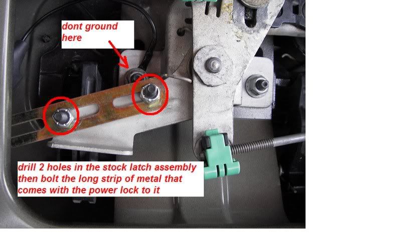

first you need to drill 2 holes in the stock latch assembly and bolt the long strip of metal that comes with the power lock(or something similar) like shown here, this is needed for leverage as the solenoid isnt strong enough to pull farther down on the latch, btw dont ground to the handle bolts, yes i know its easy but doenst ground well as the ground relys on the hinge which isnt good, ground it on the frame or bed, or ground your tailgate

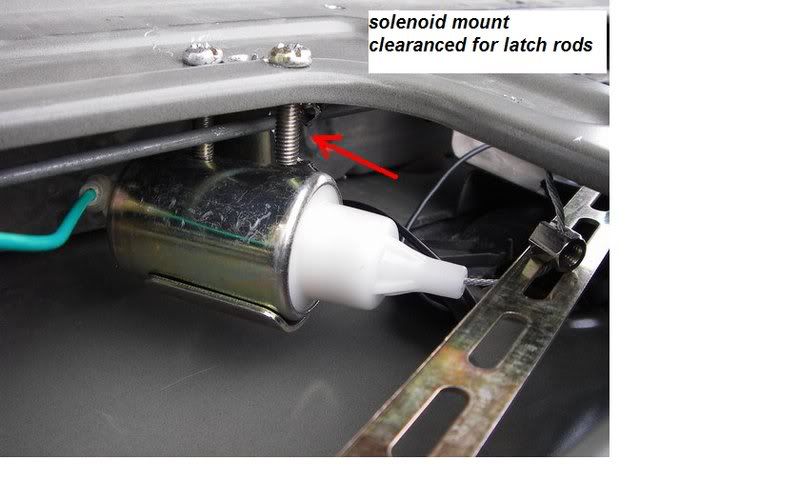

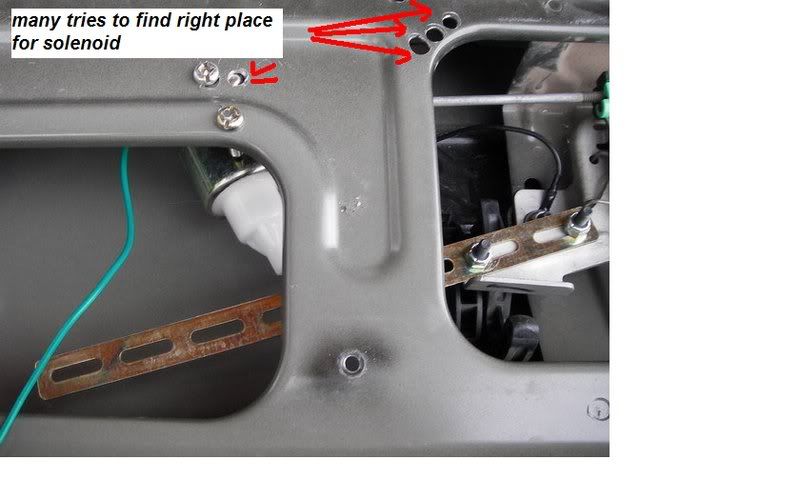

next you need to mount the solenoid, it took me a couple tries to figure out the best place for it and here is where i came up with, notice i had to pull the slack out of the latch being that the solenoid only has about a half inch of travel
you will need to clearance the mount so that the rod can still function properly(but if the stylesides allow the solenoid to go farther down the tailgate then you wouldnt need to do this)
