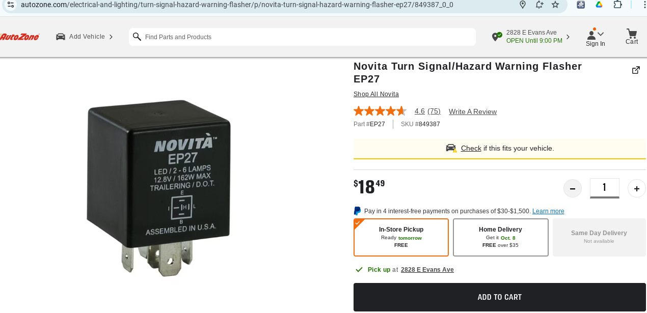

You should try an EP-27 turn signal relay for LED. When you step on your brakes or activate the turn signals and hazard lights, the relay will process it correctly as an LED load. Again, available online, or at any auto parts store.
