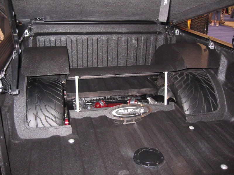

hey Rafa26, if you're truly worried about getting the tires to hook, then maybe you should get your rear-end tubbed. don't get your rear axle narrowed. that will do nothing for you. that is just an idiotic thing to do on a truck. a car, maybe...a jeep, definetaly. not a truck though
this is a perfect example of tubbing. some sheetmetal can easily be shaped to cover the tires and still leave your bed useable...just a little less space between the fenders than stock. what the guys did in the pic above is amazing looking
then you can get some 22" rims with more negative offset and some fat @ss meats.
Only an idiot who knows nothing about our trucks suspension, high wheel offset, and fender clearance would suggest that getting the rear end tubbed would solve the problem.
Oh, and that truck had the rear end narrowed
a car, maybe...
a jeep, definetaly.
not a truck though
you sure are quick to sling insults and slam on people, and yet you truly offer no usefull information. Your suggestion is to remount the fender flares. That really doesn't solve the problem. It just moves the focus and I'd say temporarily fixes it. A 285 width tire isn't sufficient for a 450+ rwhp vehicle. It's barely sufficient for my bone stock 5.4 I can spin my tires with ease. I can't imagine having another 150 rwhp with those.
and apparently I am now an idiot. wow, when did we meet? I make one post about a plausible and functional fix and suddenly I'm reduced in status from a functional member of society because someone has his panties wedged up his crack, or thinks he is Steven Hawkins. what makes our rear suspension different from the leaf sprung suspension of the past 50 some odd years...oh I know, the shocks are placed outboard the frame rails...nothing else, and nothing special...supposedly it's stiffer
so teach me then o grandoisish suspension master, why would tubbing the bed be useless? I've seen it for years in cars and street trucks. I'm pretty sure that Rafa's truck classifies as a street truck (even though it's 4x4).
1. you need room for big rims and wide tires to tuck without rubbing the fender lip right?...or did I miss the entire point of these last 2 pages of the thread?
2. maybe you meant that the stock suspension would preclude doing this because of the shock placement. you're 100% right. when stock. however, if I've read the posts right, Rafa is going to a custom 4 link. that will remove that obstacle.
3. tubbing works. you get to keep the same body lines and look from the outside perspective, and you gain the added traction from wider tires.
4. if you really want to get technical, that truck also has a quick change 9" drag axle in it. of course it's been narrowed...it ain't stock...wow, and I'm the dumb one
5. narrowing the stock axle does nothing for you. you still have to worry about tire to shock clearance if you keep the leafs. if you go 4-link, you still have to worry about the max distance between wheel well and inner edge of fender. kind of limits you in width. fill in the blank. what is the widest tire the 2004+ f150 can fit without rubbing? _________ I'll admit I don't know.
btw, that part you bolded (about the jeep) was in reference to Jeepers that swap in aftermarket axles that are 6-12" wider than their OEM axles. they get them narrowed to prevent having a vehicle that is over 7 ft wide and so they'll fit onto trailers and trails
