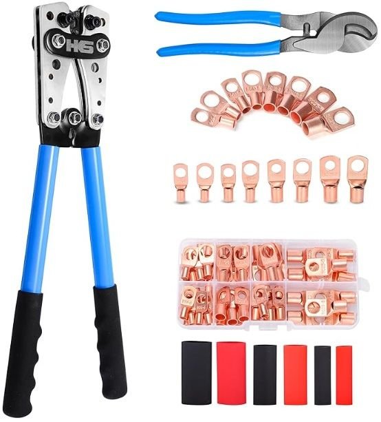

oem cable is $250 -- I may actually do it one day, just not today
but what I did, was cut the wires at the battery terminals and crimp on new eyelets. I got terminals with a post and put them on.
this is what I used pictured below
also, found my cables weren't the problem.... my starter was junk -- has a new duralast gold 35275 and no more issues
