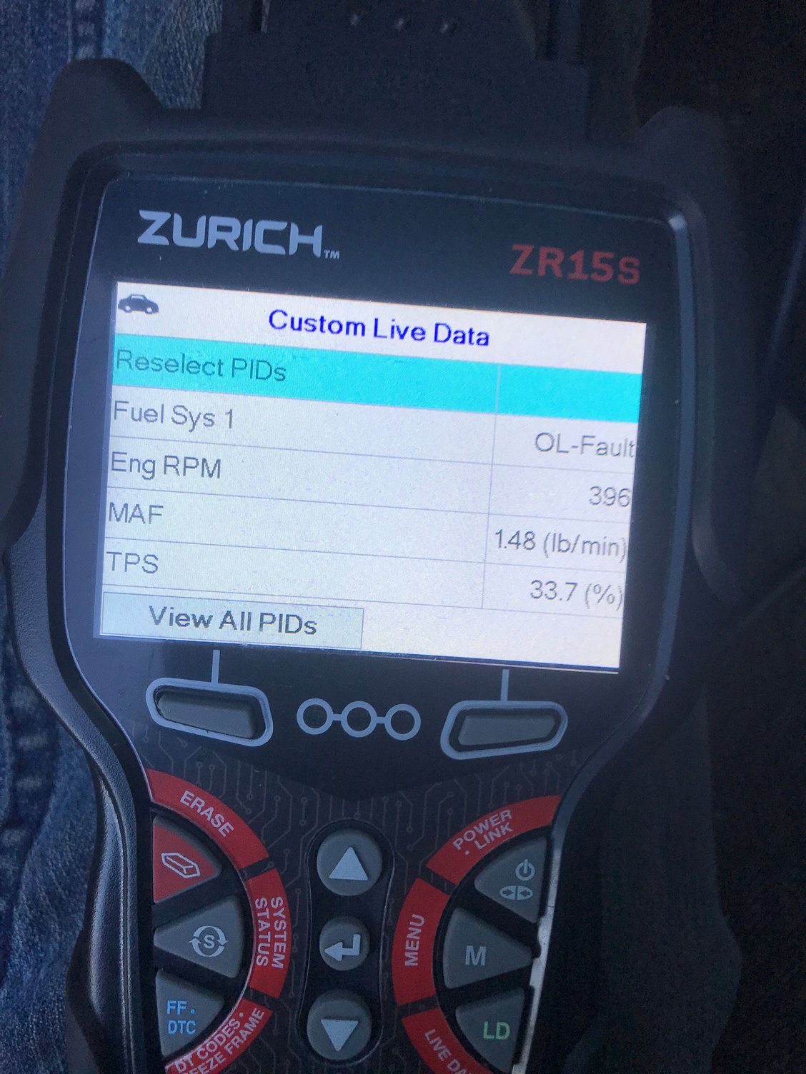

Cranking with WOT has no fire so I know the computer isn't commanding the injectors open as designed.

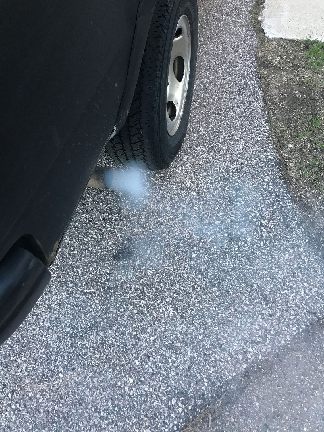

Cranking with throttle body closed or partial open will start, rev up to 1100, drops to 300-500 while making light smoke, then stalls 30-ish seconds.
Oddly to me, it will rev up no smoke lightly spraying pulses of starting fluid.
Checked 40-45PSI on the fuel pressure before and after a new fuel pump/filter/pressure regulator.
O2 sensors are about 5 months old.
No codes are present key on engine running or not.

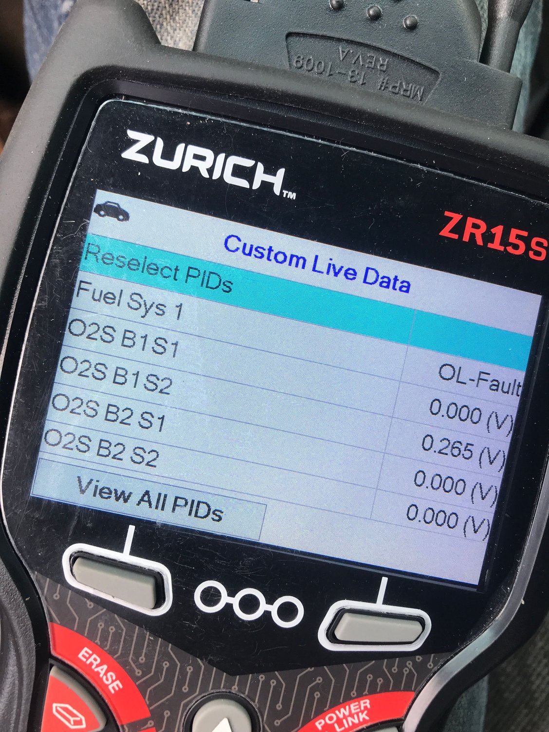

Live data showing 0 volts on the upstream O2 sensors, but I'm not sure if they get power until in closed loop.
Also confused on what an open loop fault is.

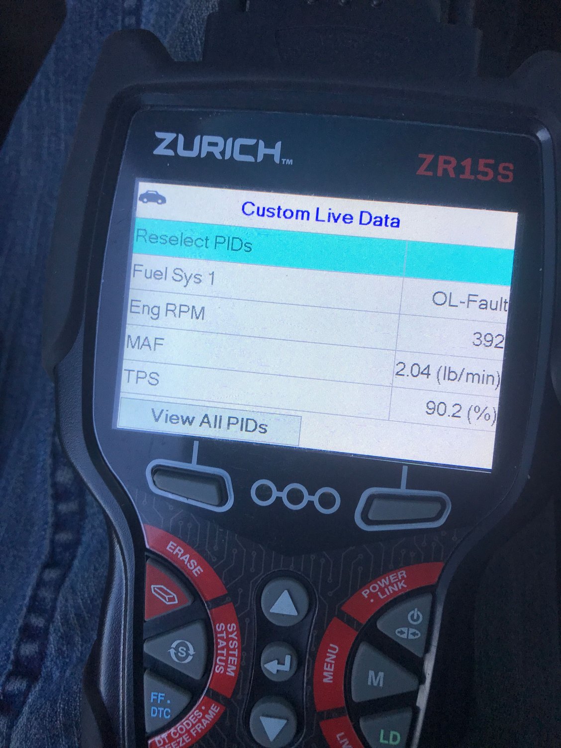

Foot to the floor while in sub idle running has no change to RPM
I would think white smoke is coolant, but it doesn't smell like it.
Seems more gray to me anyway.

Open loop system fault means the O2 sensors aren't sending a signal back to the computer. The fuel system is running in default mode, although there are likely other problems too.

Pulled up voltages.
Reset the keep alive memory, but no dice on voltages except the one downstream.
That upstream passenger side connector is too hard to get to, but did verify no voltage at the upstream drivers side connector.
