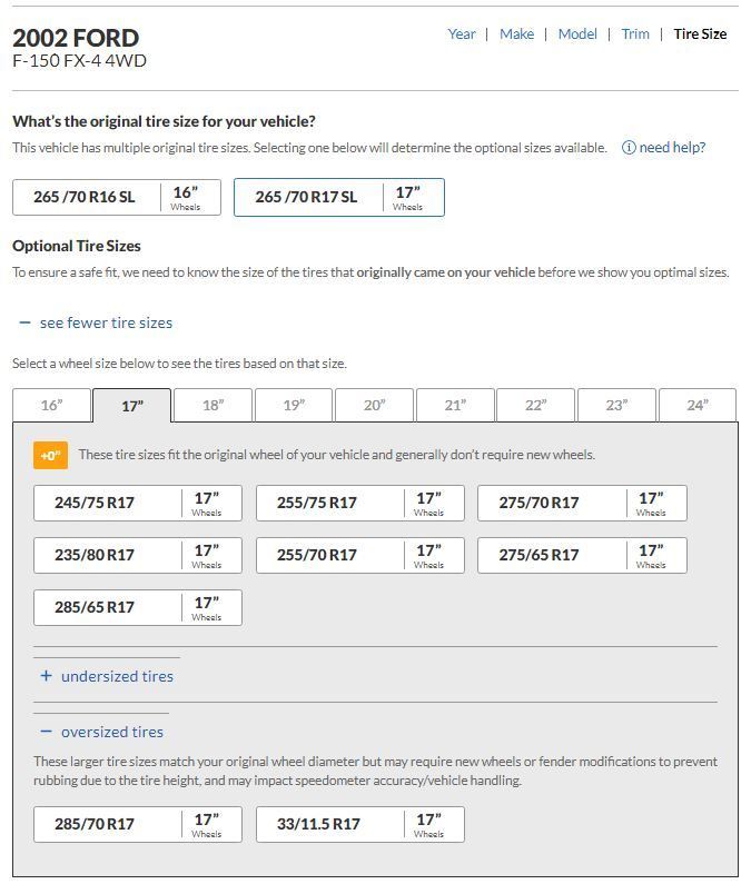

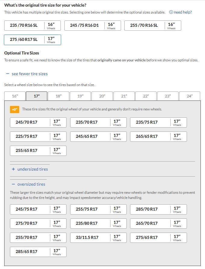

Discount Tire doesn't have the offroad package listed on the 2001 (I used 4wd Base), but I redid the search for a 2002 FX4.

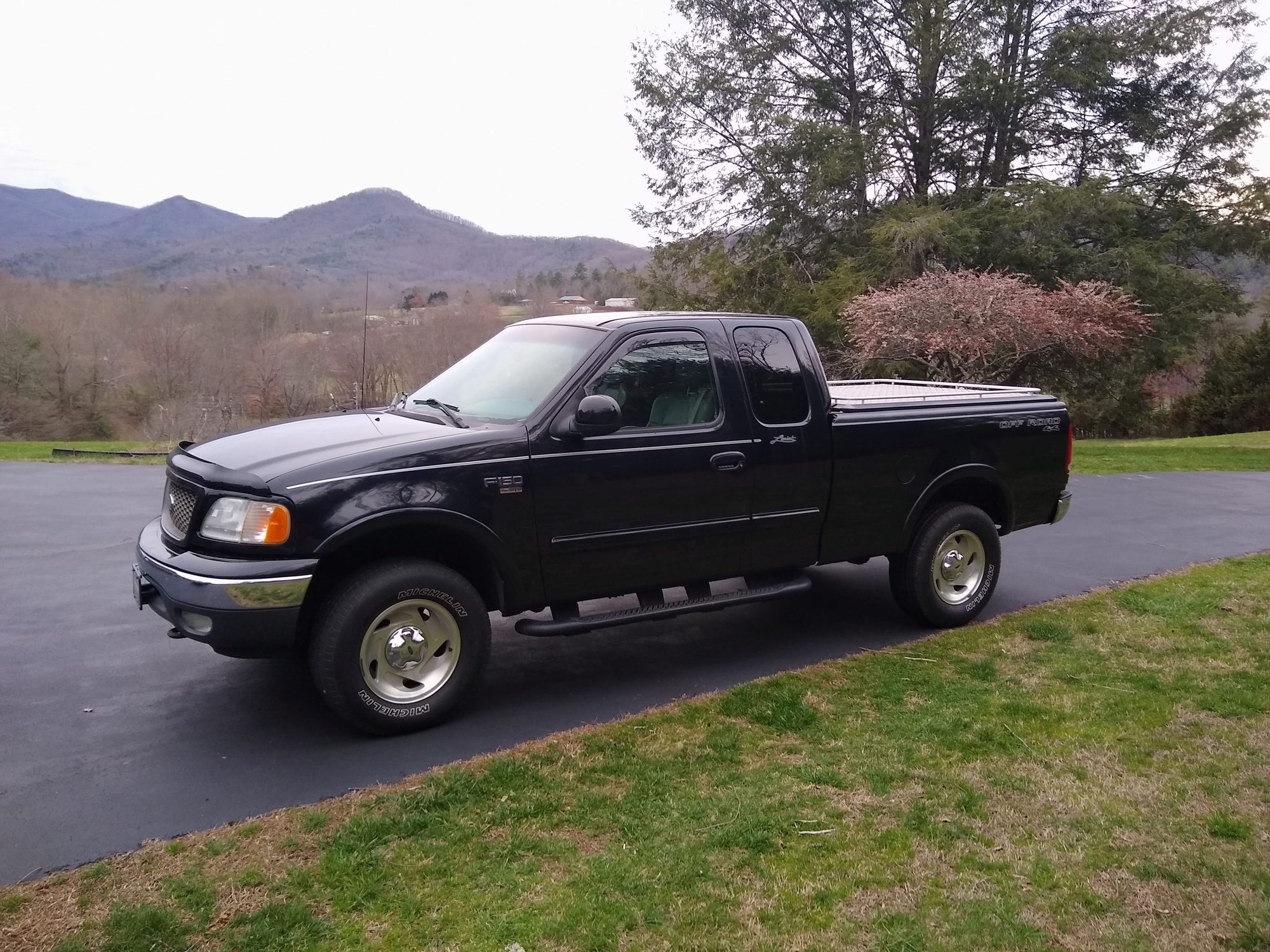

285/70x17's on a 2002 F150SCAB,FX4
This is what my truck looks like with 285/70x17s with the stock suspension. Looks like they belong on the truck to me. I went with the Firestone Destination AT's because they are C rated and have a good ride and they are also quiet. I have over 20,000 miles on them now and they are wearing evenly and are still quiet.

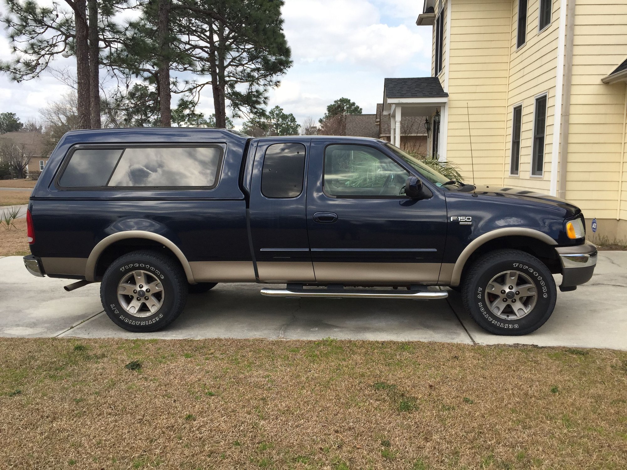

Here is a pic of my 2001 (looks like there is room, to me)

Old Mar 12, 2023 | 10:42 PM
Posts: 43,542
Likes: 819
Is that stock height or do you have a lift or leveling kit?
Old Mar 12, 2023 | 11:49 PM
Joe Wales's Avatar
Joined: Mar 2023
Posts: 5
Like I said in the OP - Bone stock truck - I bought new- with factory size tires.
