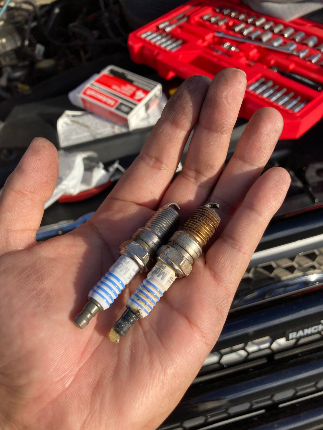

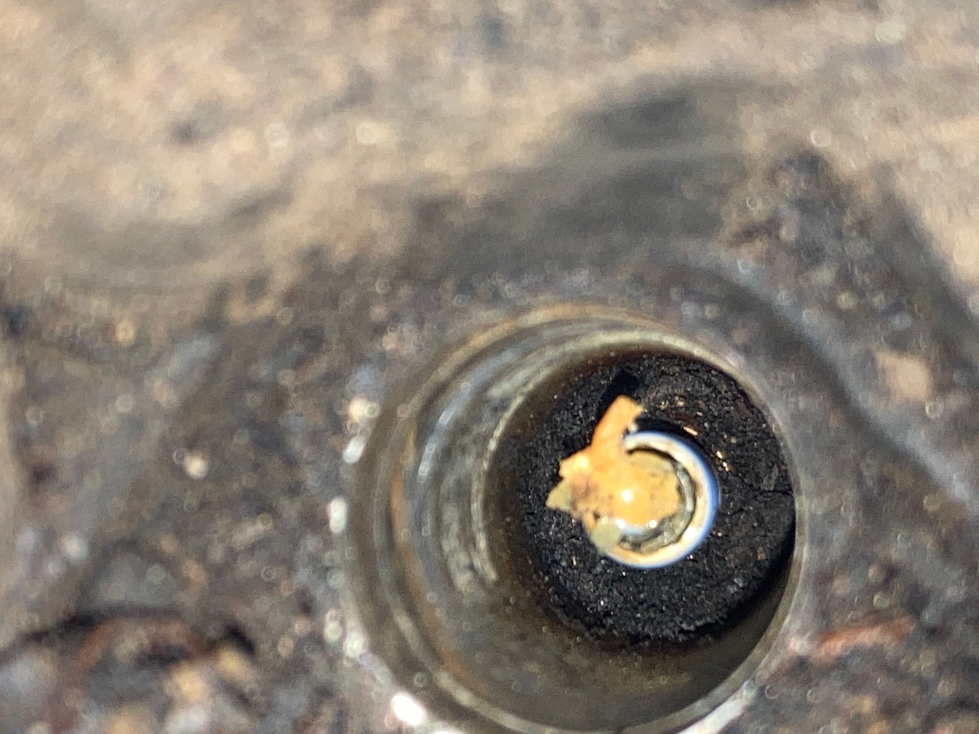

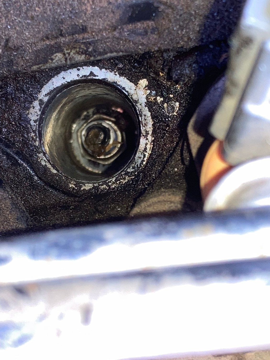

Changed spark plugs, old and new
Before photo: so much f**king grime that the socket wouldn’t grab the spark plug
After: I had to clean and scrape it up then vacuum it out with a little Ryobi vacuum that my dad made a custom nozzle so it can fit in the hole.
