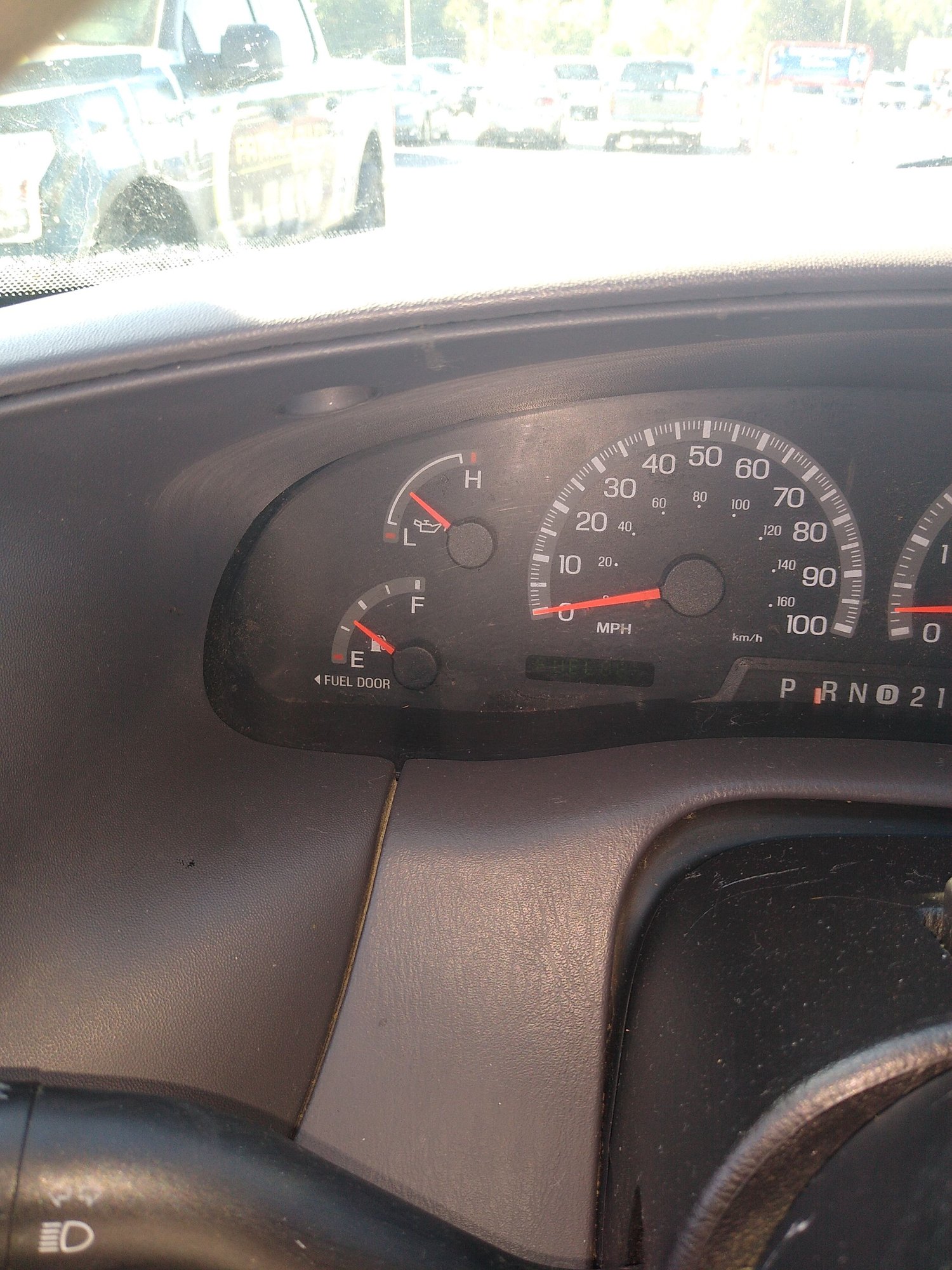

Fuel gauge shows above full.
I got my '99 F150 used, years ago. Ever since I have owned it the fuel gauge, when tank is full as shown above, also still shows about 1/8 to 1/4 of a tank when the tank is bone dry.
I've been told this is likely because of the float in the fuel pump which I'm guessing was previously replaced. Otherwise, is there a good fix or adjustment for this?

Fuel gauge reading 225
It also flickered to 255.
so I guess that's telling me that the tank is full, which I already knew... But the gauge is show "beyond full" and it goes down to a little above the 1/8 tank mark when I run out of fuel.
So I'm back where I started. How do I fix this?

Fuel sensor is right. Gauge is wrong.
Don't know if you can see the digital readout, but it shows fuel level at 84 which is right, and shoul be just under 1/4 tank... But the gauge/needle still shows above 1/4 tank. So it seems the fuel tank float is ok, but the gauge on itself is off.... So how do I fix that?

I don't know how to fix that, but it looks like your gear pointer is out of adjustment. Here is how you fix this:
https://www.f150online.com/forums/ar...inter-fix.html

Fuel level sender;
140 Ohms +/- a small amount Full tank.
20 Ohms +/- a small amount for empty.
If both are ok, dash panel is in fault.
Measure either at tank or the dash panel 16 lead connector pulled off.
Measure between #5 pk/or and #10 yel/wht leads.
Be sure there is no power on either lead, first.
