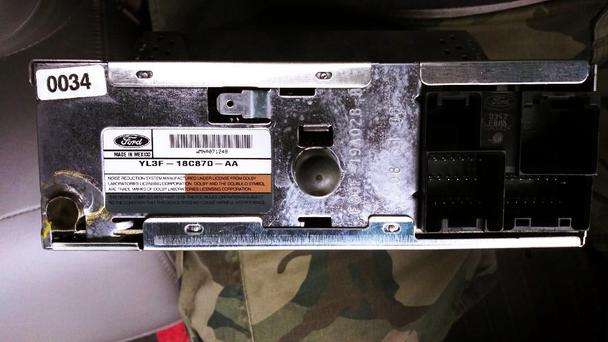

I bought the Ford car stereo Removal Tool today at Autozone and pulled the deck out of the dash.
I unplugged the two wiring connectors and the antenna cable all from the back side of the deck and looked the deck over. I took some pictures of the deck (see below) and then checked the plug in areas over, sprayed a little WD-40 into the On/Off shaft under the On/Off button, pushed it on and off several times just to see if it might help somehow, maybe by lubricating or even cleaning the inside area. Plugged the deck back in and then re-installed the deck.
The Volume is now working as it is supposed to, after I had driven the truck today for about a half hour the driver door speaker came back on while driving and stayed on the rest of the drive (though this has happened several times before where the driver door speaker comes on and off at will.)
I'll be curious to see if removing the deck, unplugging it and plugging it back in may have helped the deck to somehow start working properly.
