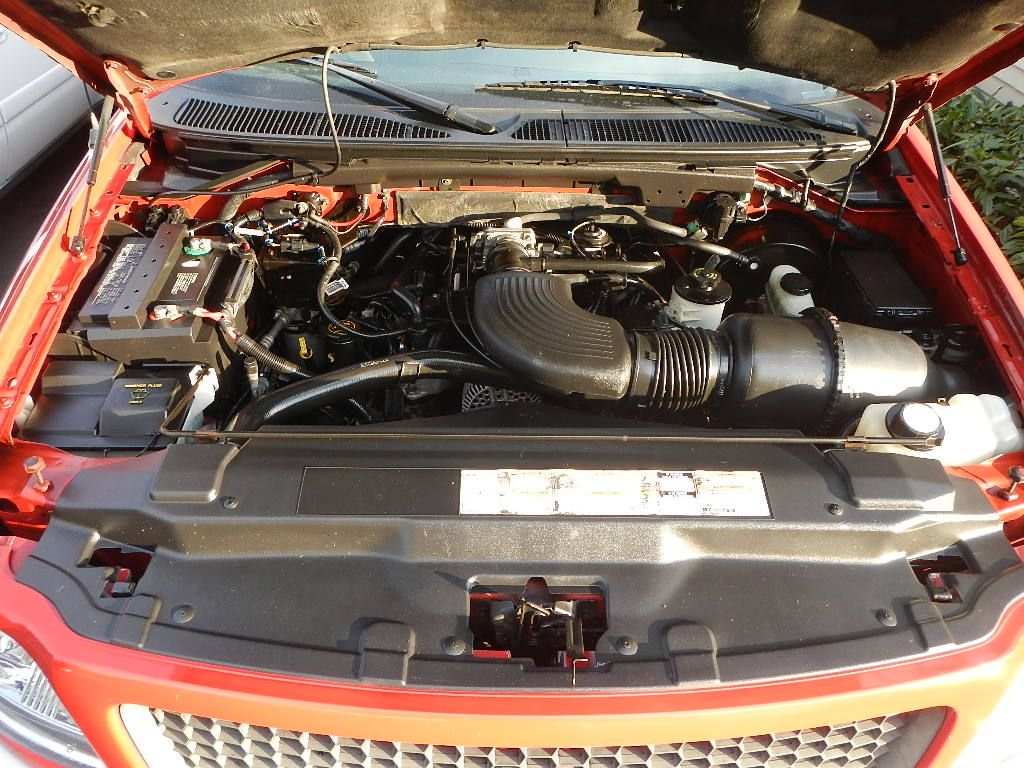

I am not finding a hose over my battery. Can you tell me which hose it would be in my picture (s)
that I have attached?

I believe he's referring to the little hard vacuum lines that are *behind* the battery that go to the climate control system. Remove the battery to see them. There's an accumulator back there too.
However, if there's a problem with them, the climate control system usually doesn't work right - airflow stuck on defrost or going to defrost under low vacuum conditions.
