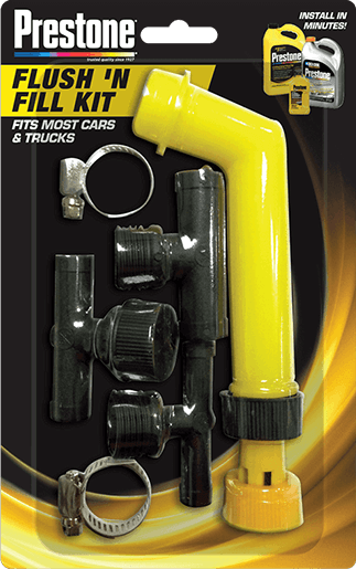

http://www.prestone.com/products?detail=AF-KIT
