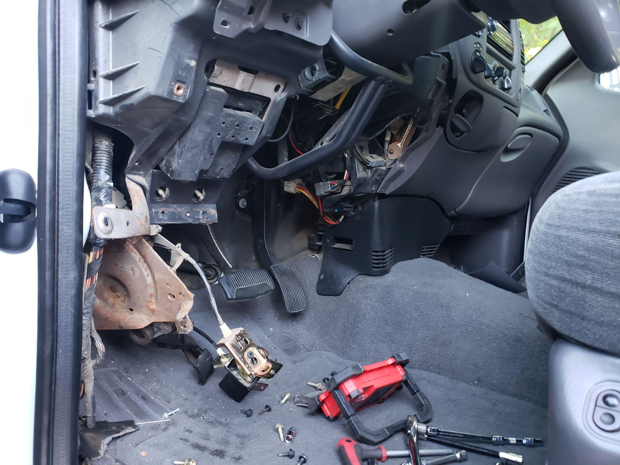

well, I removed it.... switch tests good with an ohmmeter..... I did hit the contacts on my wire wheel. I will get some electrical parts contact cleaner in the morning. I also found my tube of dielectric grease....
I did plug a test wire into the female spade in the harness, and ground it out to some bracket somewhere, and the light did come on on the dash....
so hopefully it is just dirty contacts.... I will try also and see what I can spray contact cleaner on down there to possibly try to clean up some of the grounds maybe
getting that switch out was a BEOTTCH!!!!!! could just be my bear paws, but man, that sucked

I probably took out way more than I needed to... hopefully I remember where everything goes....
Old Oct 28, 2019 | 12:17 PM
jimbo74's Avatar
5 Year Member
Joined: Apr 2018
Posts: 818
Likes: 35
From: NorCal
Well got it done, and it works. Didn't even get cleaner. Just used a baby wire brush on a dremel and got the contacts on the switch
Used all the screws, so that's a plus, and don't have extras.
I did break some plastic, not sure from where though. And some clips
. Oh well.
