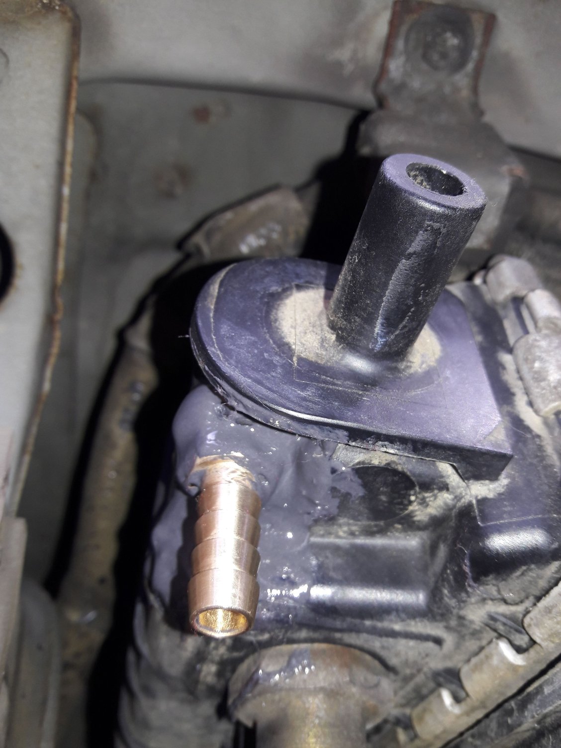

ok, so I need help figuring out which replacement I may need to buy, not sure what the options are. Do I have a tow package? I don't even know. I do have a trailer hitch
I snapped the top nipple off my radiator on the driver's side. The one that goes into the coolant reservoir. It is maybe 3/8"
So here is my idea, I will drill the hole a little larger and try to thread in a barbed nipple.... it should work, and as I am going brass into plastic, I am either going to snap the plastic, or it will work and shouldn't leak,,,, what do you think?
otherwise, it is a new radiator, or pick-n-pull time.....
like this:
brass hose fitting, adapter, 3/8" barb x 1/4" NPT male pipe

That would be a good temporary fix.

should I get a 1/4" NPT tap and do it that way? or just use the threads to cut the plastic?
Old Jul 16, 2018 | 09:25 AM
I would get a 1/4" NPT and tap it. Then use some 2-part epoxy.

if I thread it, where is the epoxy going to go?
about to go on amazon and order a tap and some jb weld

After you snug the barbed adapter on. Mix up your 2 part, and put some around where you screwed it in. Just an added layer of protection.

Already done 😉
I used jb quik

My hands are all stinky from the jb qwik
anyways, says it fully cures in 6 hours. It is already hard.
I used non-chlorinated brake clean before the jb to clean the area and promite the epoxy to stick, especially since I can't access around it very well. The epoxy is all the way around the base of the nut part.
worked slow drilling it out, the material is thin walled, and is right on the edge of the tank, it has to be straight, or I might have busted out the side.
hopefully this works!

That fix should last a long time. It's not under pressure, and that JB stuff should seal up nicely. Much cheaper than a radiator! The only thing I may have done was use a step bit instead of a twist bit to help reduce the chance of it grabbing and tearing/cracking the plastic, but it looks like it worked well for you. Good job!
