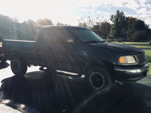

An otherwise pretty solid truck, made it's way up to Fort Drum, NY from Texas so I'm trying to knock out as much as I can before the corrosion, errr snow, starts.

Attached Thumbnails '03 4.6 4x2 at a good price, now begins the labor of love-f1502.jpg

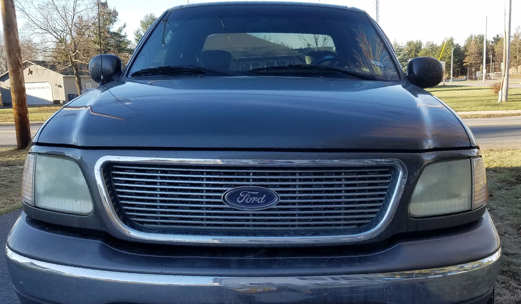

So I picked up four O2 sensors to get them all on the same page. Hopefully that's the fix, the MAF is next. Also did a little cosmetic work, really revitalizes the look.
Before.
After.
60 bucks well spent, even came with bulbs so nowf I have spares.
