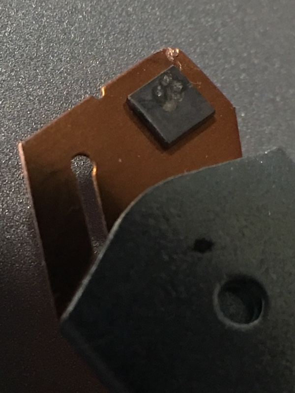

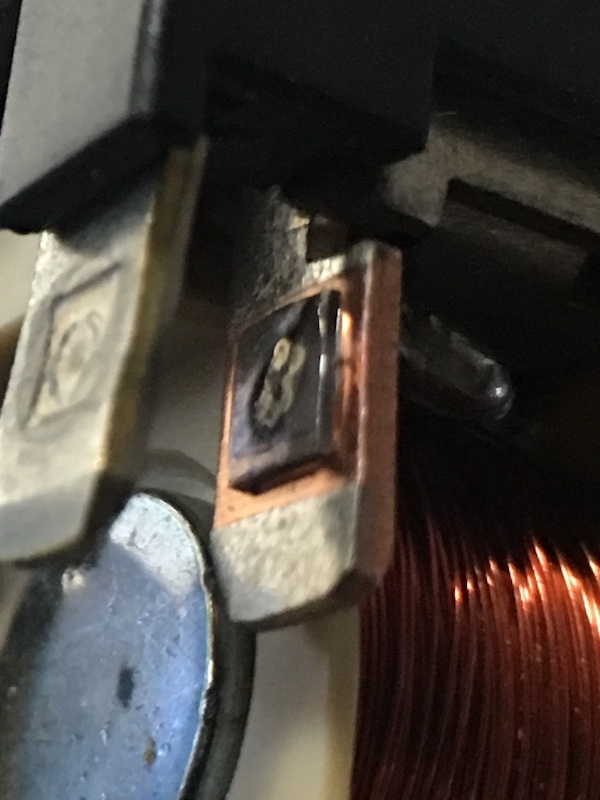

I pulled the pump relay and took it apart. Contacts are SEVERELY pitted. Working on pics but the "NC" side of the connection is convex, the working "NO" side is pretty much flat at the edges, but the pits are effectively concave and there's enough roughness that I could easily see how the relay would be the issue. I put the trailer battery charge relay in its place (same relay) which I assume is in good shape as it's working fine and I've rarely pulled a trailer with a battery so no frequent load on that.
Hoping the relay swap and a new filter will solve it for good. I'll report back after further testing...
