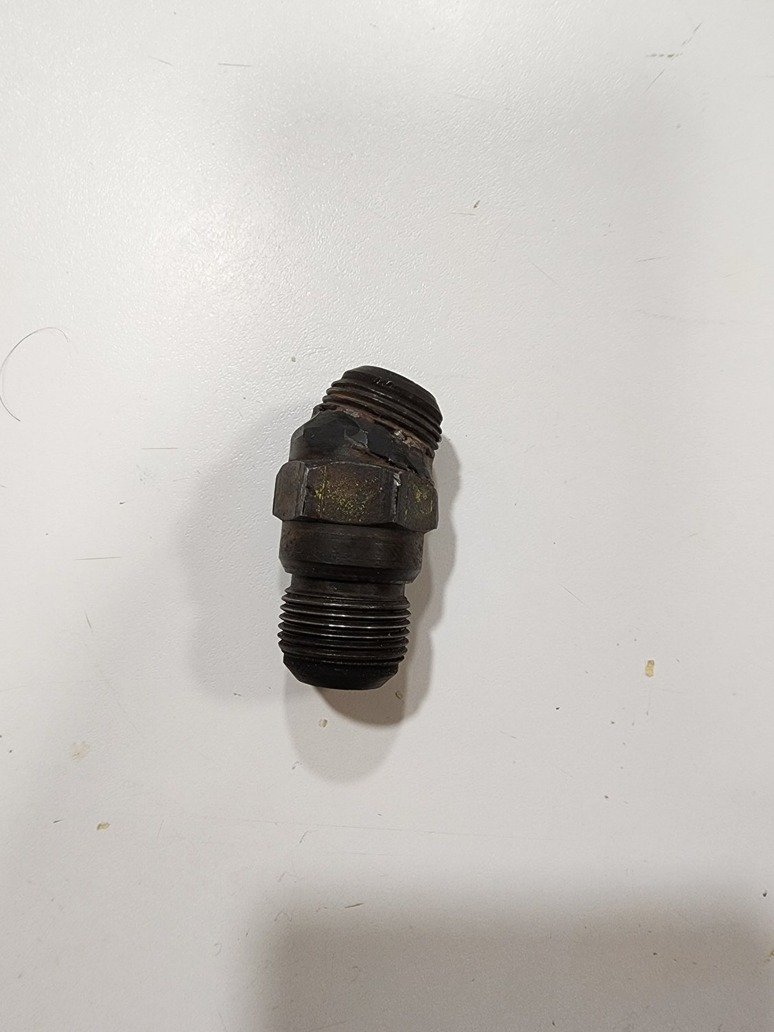

Exactly my problem, header bung is welded about 15-20 degrees the wrong direction, now the EGR won't fit. I thought I had a work around, but it didn't seal (I cut the EGR tube to header connector, bent the end and used High Temp JB weld to seal it). The JB has held up fine, but the angle wouldn't let the connection make contact with the flange a
nd the cone a few weeks later it set the EGR code. any Ideas?

What i ended up having to do was i bought a brand new EGR tube from local parts store for about $110.
then we sliced it about half way up the tube to the egr on the intake side. Tried to get a thread started at the top and on the headers. Once we were successful (took a couple slices with the dremel) catching a good thread top and bottom, we welded a thick washer in, cut it flush after fully welding the gap. Then the EGR worked as intended.
if you have your old EGR tube you might be able to use some material from that to lap joint it. Probably easier than the washer approach
