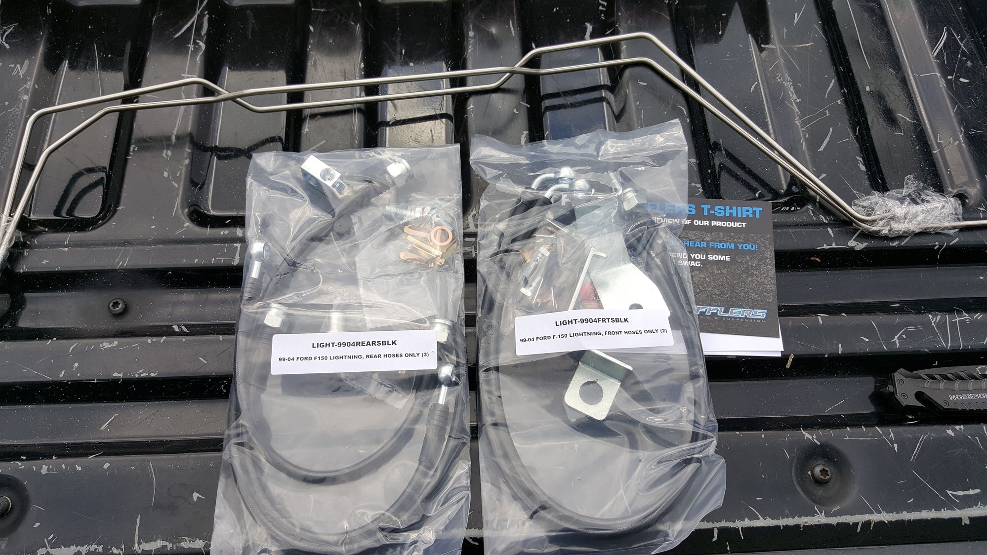

Has anyone installed this kit on their tenth gen?
My brakes are about as dead and spongy as you can imagine, and I've actually noticed a reduction in braking power compared to when I bought the truck in 2010. I'm sure the factory rubber hoses are in need of replacement.
What pads and rotors should I pair these with?
