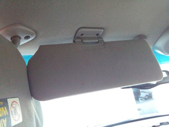

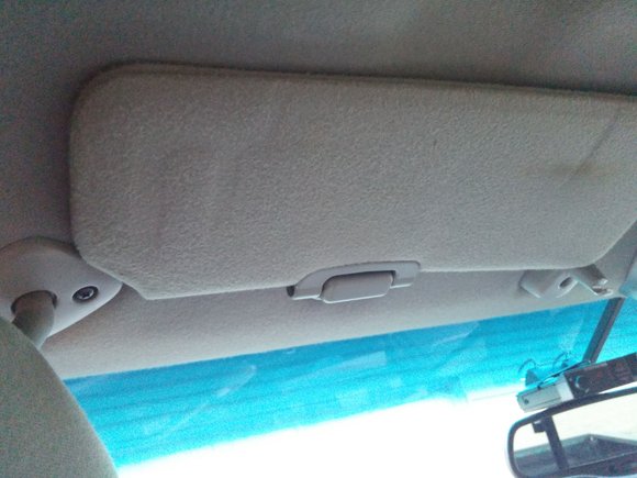

So I picked up an autodimming rearview mirror last time I was at the junkyard and got that all working.
This time we started looking at the visors. I wanted the secondary visor that you can pull down after the main one is off to the side.
I didn't see any F150s with it but nearly all of the Expys and Navs had them. The Expy one didn't fit, the secondary visor is part of the main visor, and the main visor screws were off by 90 degrees. However, the Navigator has a standalone setup, see below. We took it off and saw there was a slot and square holes with snap in metal pieces for the screws to thread into. We took the metal pieces as well (you'll need these!). We looked at all the F150s from 98-01 and they all had the holes ready to use.
So you have to cut a hole in your headliner first of all. Don't be scared. I can get you measurements if you want. I used a screwdriver to measure off reference locations in the donor truck. Cut slow until you find the slot or square holes and work from there. Pop the two metal pieces in the square holes stamped in the metal roof header. The slot in the header is filled by a tab on the mirror mount to align things. Screw it into place and you are done. It's all quite obvious once you pull the donor visors. Again, get those metal pop in thingys from the donor truck! They just pry out with a flathead.

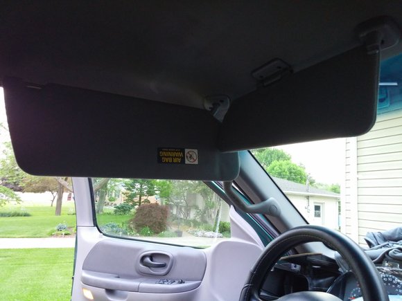

Results are, well, it's just a bit too wide and interferes with the post on the right. It still works OK though. It kind of binds a bit as it moves, and will actually pop behind the post when you move it all the way down. You can see it in the pics.
Pics.
Haven't done the passenger side yet, but both sides have them and I grabbed both.
I wish I had grabbed the post from the Nav, I have a feeling it is offset a bit. If you got both the main and secondary visor along with the post, I'm sure there'd be no interference. I didn't want to pay for the other visors. They were lighted however if you want that, but I see no wiring in my truck to make them work.
You could always just trim it if the interference bothered you, but I don't think it'd look good cut. If you got them re-upholstered then you could easily cut it down some first.
