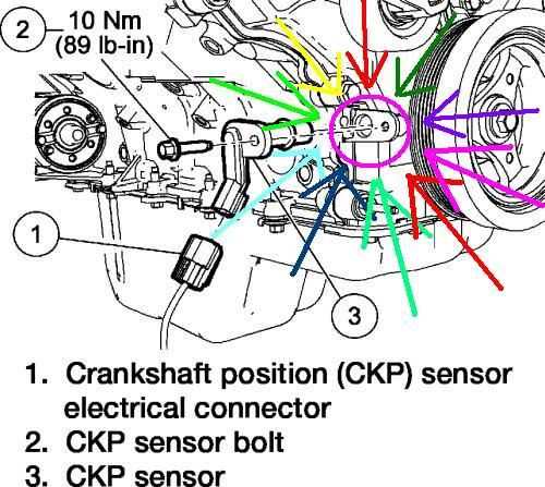

Now that crank sensor MAY be a possibility. Bluegrass Nailed it. Its like I;m loosing electrical power completely, and thats why I'm not getting a CEL. Thats why I performed a wiggle test on all the wire harness I could get ahold of while the motor was running. Not a single hiccup in the way it ran. I did NOT however, inspect the crank sensor or the wiring to it.
Where it looks like that sensor IS, it would make sense that if something was screwed up there, it COULD be affected by a stream of water from a car wash/underbody flush.
Would that cause the symptoms I'm seeing?

I have a question.... if it WAS the crank sensor, wouldn't I see the tach go nuts or at least "flick" when this happens? I would expect that to happen if for some reason i lost main power, but im not sure if it would act that way if it was just the crank pos sensor.
I'm going to try to wiggle the harness down there after I get home, and check all teh fuses/relays for contact.
