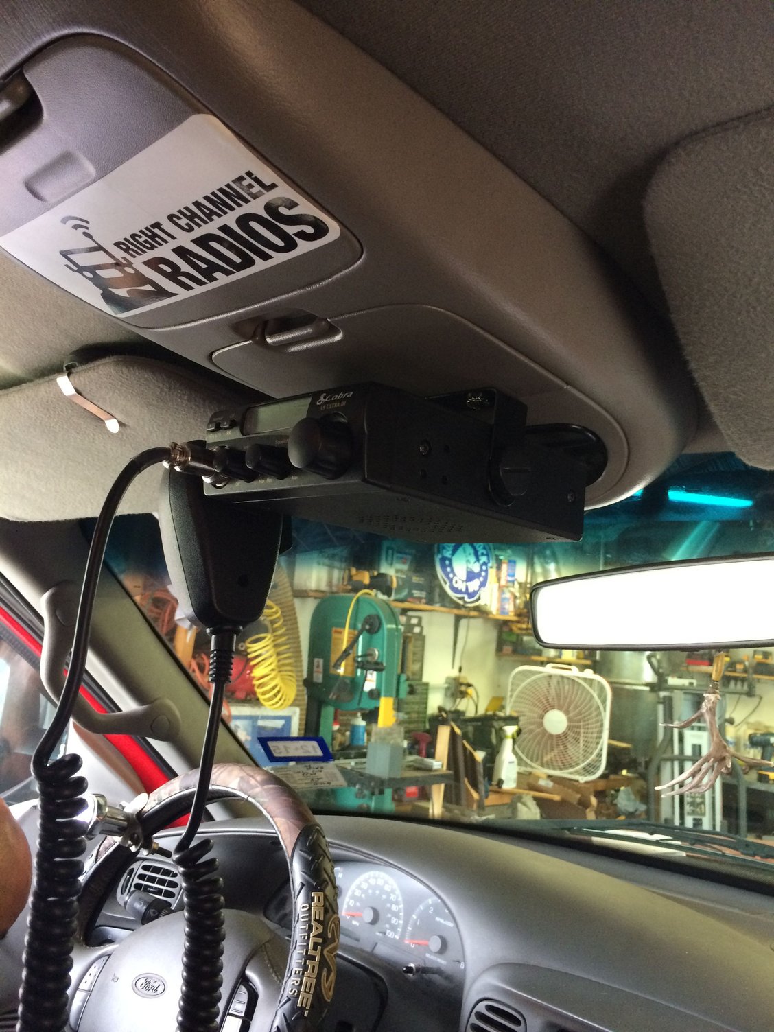

I ran the wires from the cb trough the headliner down the a pillar under the dash to a noise filter than I ran them to the fuse box under the hood using a push on connector
