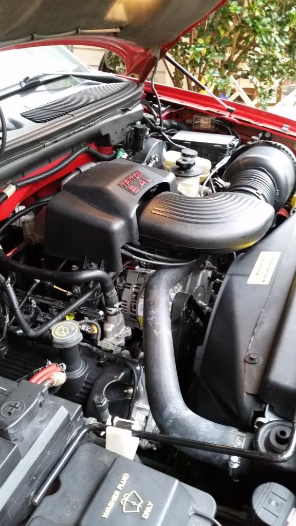

I have been cleaning mine off and on over the last 15 years with no issues. I try and not blast critical areas like coil/plug areas and the electronics. I also only use regular hose as to not inject water farther into things. The other thing I do is take a gas leaf blower and blow the heck out of it after washing. The neighbors all look at you funny but a good high velocity blower get most of the water off. Like a few mentioned I will let it dry out good before starting it. Also do the same on sons Mustang with no issues. Still looks like a fairly new engine bay. The alternator and front engine cover are new in this pic due to recent repair so reason nice and shiny.
