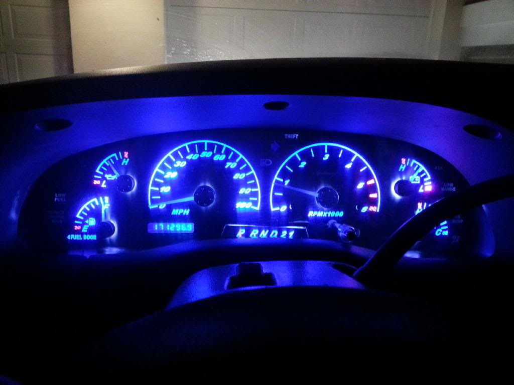

If you are looking for a different look, there are some nice choices out there. I ended up changing mine actually.
