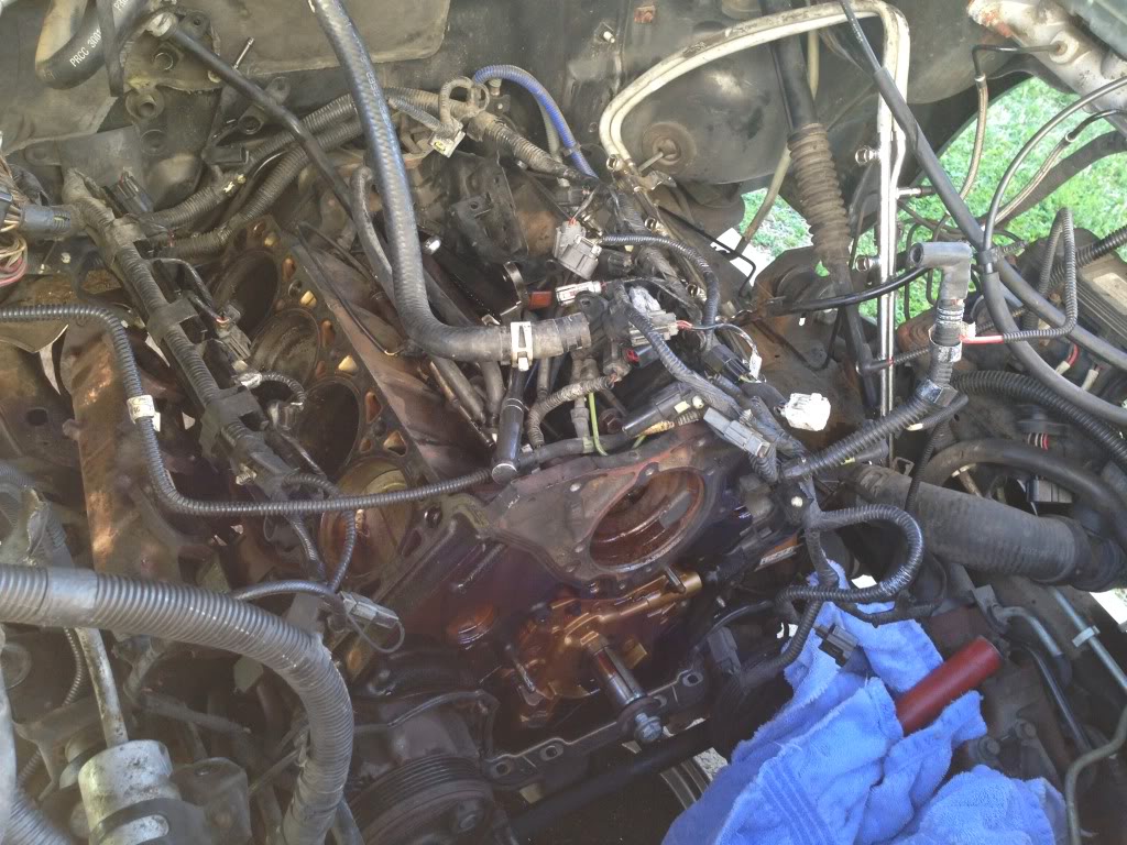

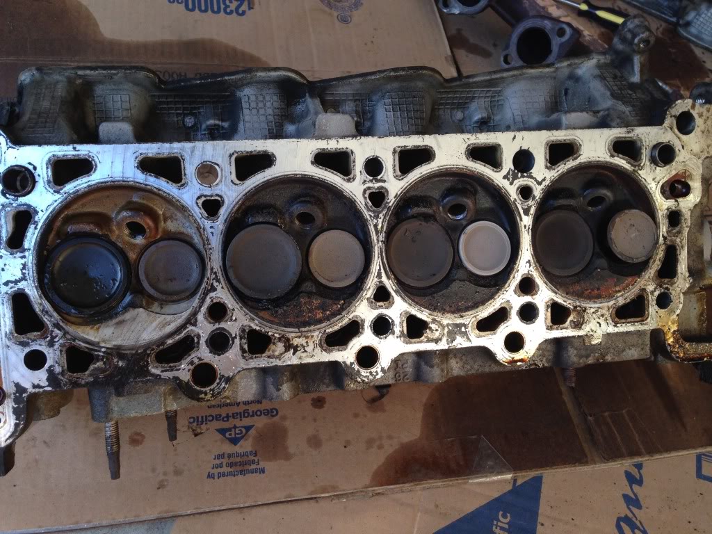

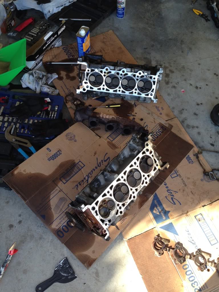

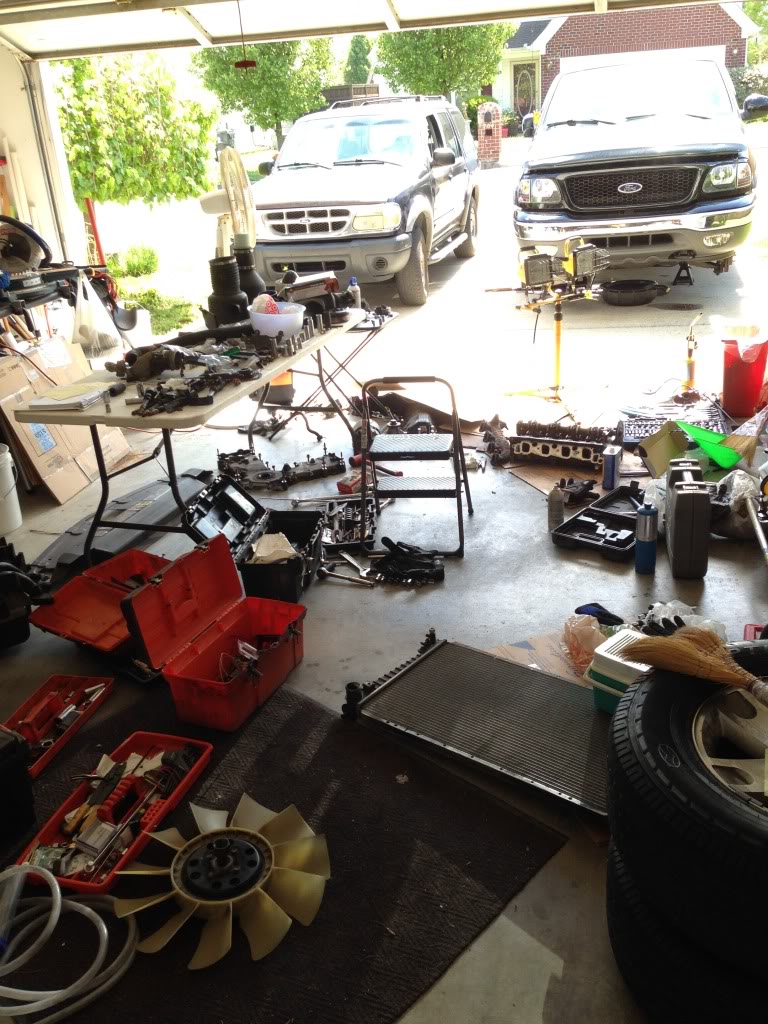

After ruining my parent's garage, I finally got my truck up and running. I broke a lot of rules with regard to timing procedures, but the engine didn't blow up, and I'm so glad I don't have to drive the family beater anymore.

I did the job with only hand tools in a driveway... it sucked.

Check the surface of the heads? Or just new gaskets and back on
Old May 6, 2014 | 10:18 AM
AndersonS's Avatar
Joined: Feb 2011
Posts: 752
From: Nashville, TN
My dad had an old straight edge, and the head seemed flat enough, so I skipped resurfacing the heads. Hopefully that won't be a bad decision.

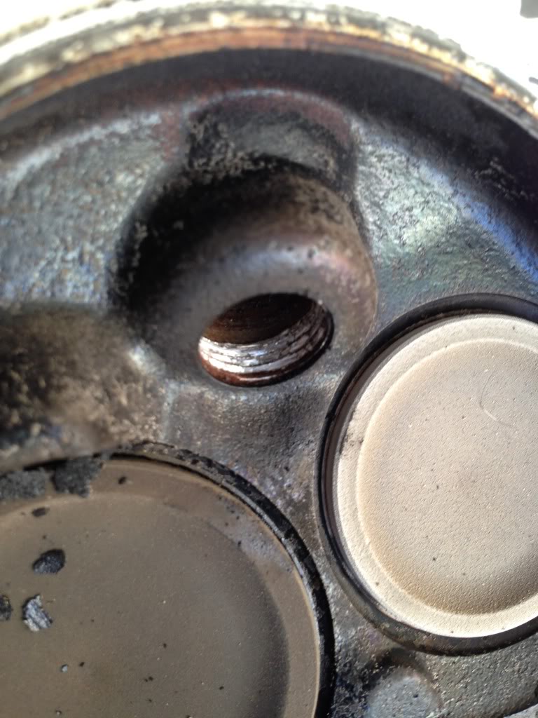

As for the plug threads, I chased them, but hole #3 looks pretty bad...

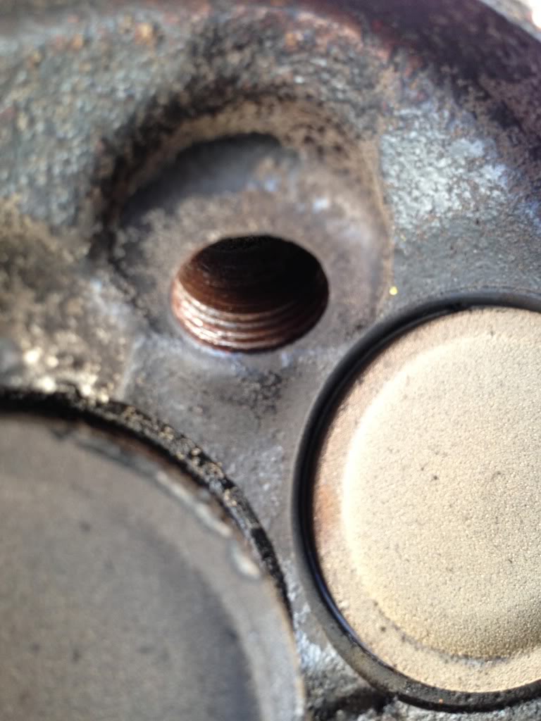

The rest of them look like this...

Looks a little iffy. I can see threads, but they look like they were crossed up at one point.
They may hold...? I would personally put an insert in there just to avoid being stranded or a tow bill.
How did the cylinder walls look?
