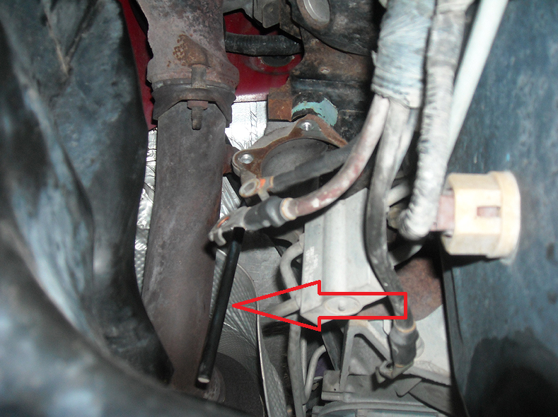

My brother-in-law has a 99 xlt 4x4 5.4L with an oil leak. I'm trying to help him figure out where the leak is at and think I may have possibly found it. Not being a Ford guy I found a tube that I don't know what it is or where/what it attaches to so I could use some help from the community. The tube in question is about 5/16" in diameter behind the starter and housing. It looks like some kind of overflow pipe or tube.

How about posting a link to the post you found? Right click on the post number at the very top right of the post, next to the little triangle. Either that or right click on the pic itself and post a link to the pic.
Off the top of my head, without seeing a pic, it could be the A/C condensate drain or the tranny vent or the front axle vent.

Is this the pic?
Vent tube off the top of the trans
If that is leaking trans fluid it is over pressurized... then I would check the fluid level. Other possibility is the fluid is too hot

That's the tube. I couldn't find the thread it was in to link it into this thread. Thanks for info. He's getting the trans fluid changed & flushed. I'll be sure to let him know about the overheating possibility.
