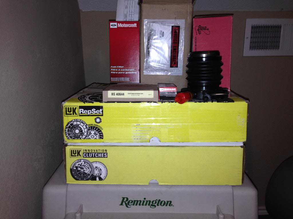

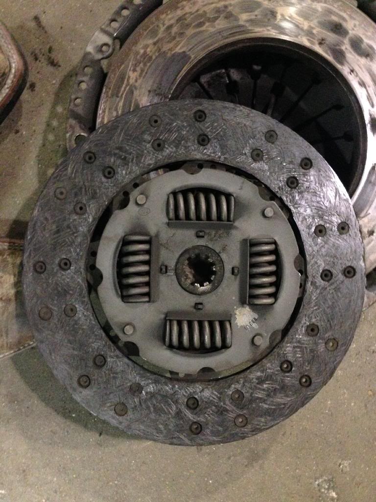

Clutch install pics.

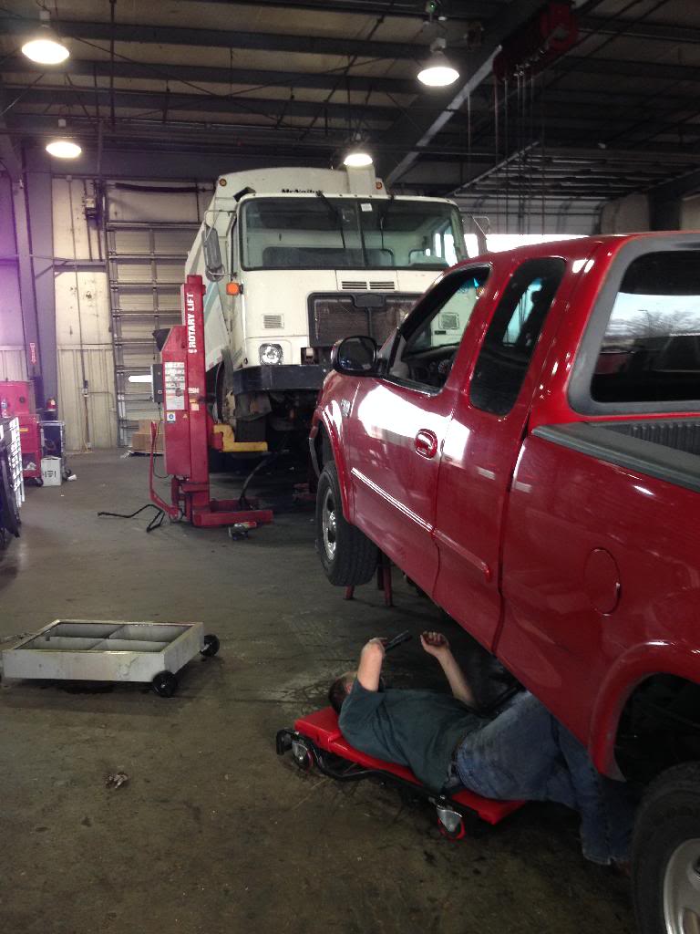

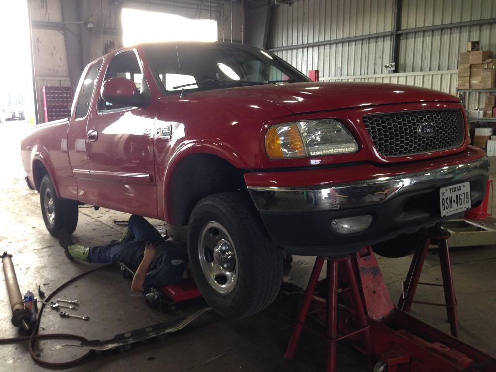

Had to move the truck to another bay, no torsion keys in it.

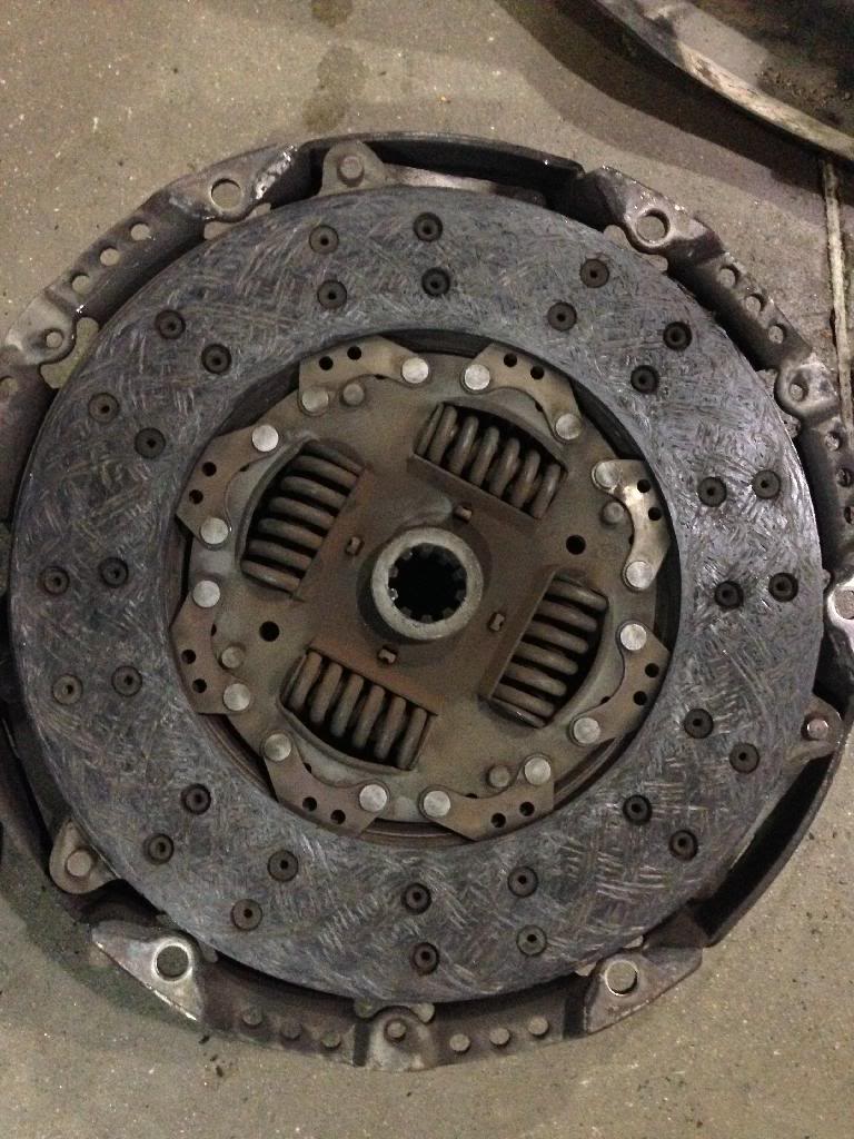

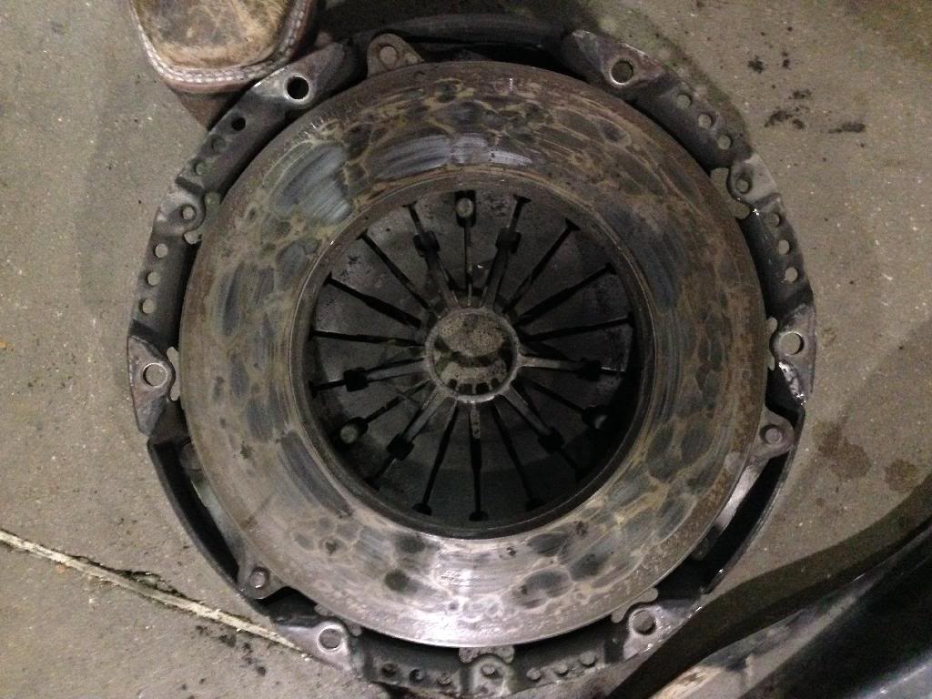

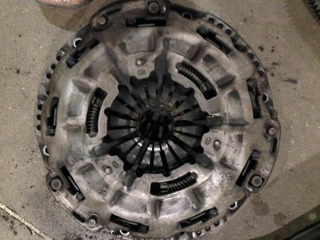

Factory clutch components with 150k.

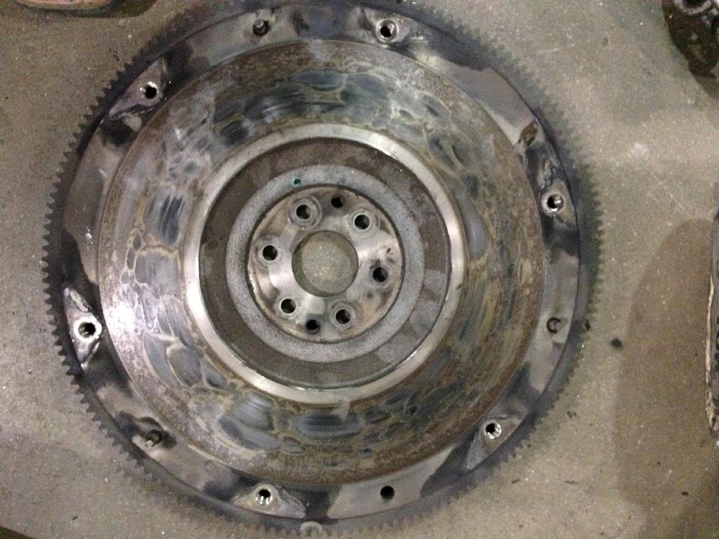

That's a serious floor jack! That flywheel looks torched. Wasn't much left of that clutch eh
Great looking truck

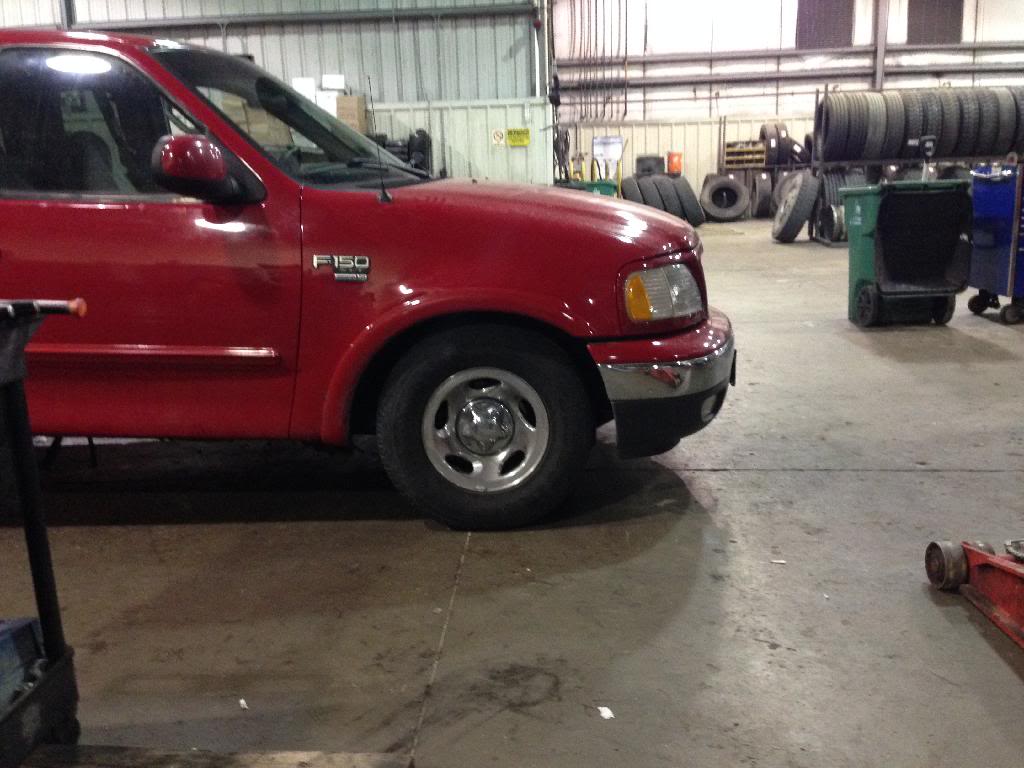

Thanks, it's my beater but still looks good for a 99.
It is a beast of a floor jack, a little overkill for my truck. I was under the impression we would have it up on a lift but unfortunately the lifts in that shop were way too big for my truck.
The flywheel and clutch looked worse in person, flywheel was covered in cracks. I was impressed though the clutch didn't slip at all until 5000 rpm. I'm pretty hard on this truck too, lots of fishtailing, burnouts and 4x4 drifting
