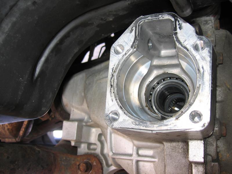

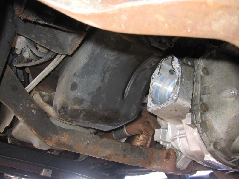

Pretty basic job. I now have 4x4 again. Cleared away the snow and ice so it melted before today, a couple big pieces of cardboard and temps in the upper 40's made it comfortable. It took me just over 2 hours using only hand tools.
Axle tube came off easy, plenty of penetrating oil over the last week.
No damage in the diff and all the pieces were laying there. Removed the mount bolt on the tube and loosened the other two so the diff would pivot down.

Plenty of room and only jacked the right wheel so I could turn it. Did remove the sway bar link.

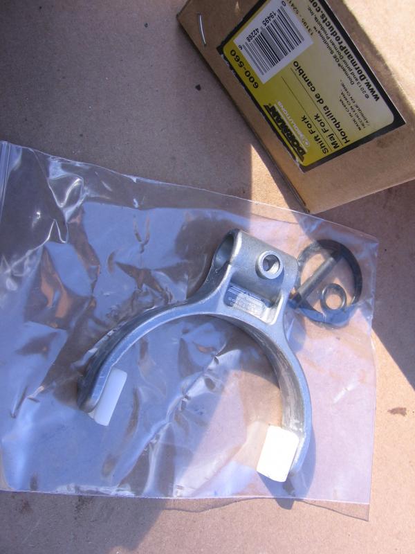

New Dorman 600-560 fork looks identical to the original including the casting marks.
