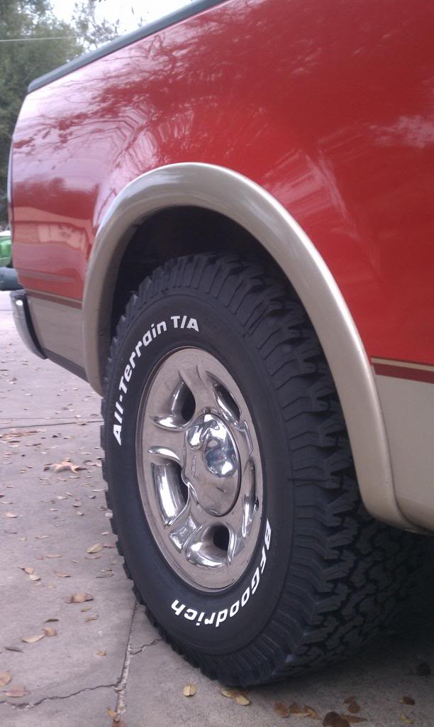

You can run 33s on a 2WD with a simple 2" front leveling kit. Technically my tires are still metric sized (285/70/17), but it equates to roughly a 32.7" tire, which is close enough to 33" for me. This is a simple, inexpensive way to put 33s on your truck without having to lift it.
However, if you want the real deal, a 3" suspension lift is the way to go. You could also do a 3" body lift; it's substantially cheaper but doesn't look quote as good as a suspension lift.
